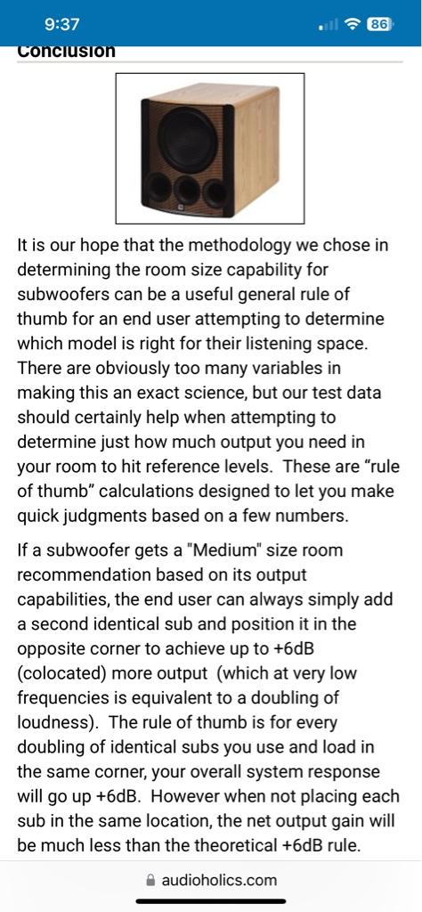

Here’s a TLDR from this article from right here at AH. https://www.audioholics.com/loudspeaker-design/subwoofer-room-size
A theoretical rule is not necessarily what happens in practical purposes.
That’s true. But Ime it’s pretty much a rule of thumb, and I believe that’s the case and seems to be supported by Genes recommendation above. I also believe the literature in the article to be correct and reflects what I said.
