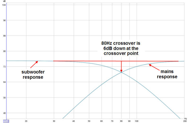

Exactly like that but its a gradual takeover so usually its best to cross over with a good margin often recommended an octave above (which is double the frequency) of the -3dB usually listed in the speakers specification(48hz for rp150m) so cross at 80 to 100hz with speakers set to small.
To help visualize a crossover this might help as Leemix said, it's gradual, not a brick wall filter (this example is not specific to your gear, tho).
