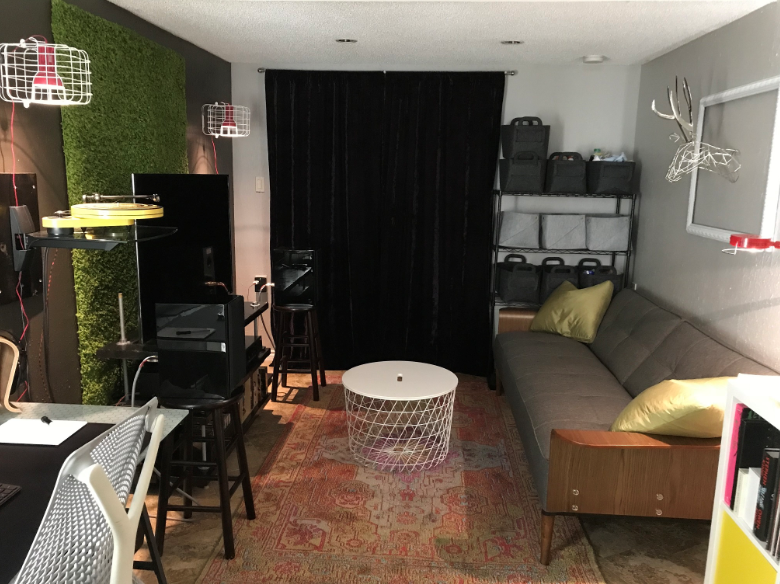

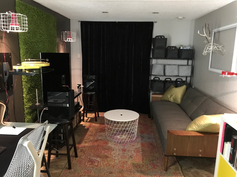

I found this picture that I took in February of this year. I have since replaced the Ascend Acoustics Sierra-1s with KEF 750s and the ULS-15 MK2 pretty much fills the void you see a the end of my entertainment center:

Nice spot! Is the HSU you already have ported or sealed. Whatever you might decide to get if you go that route you should never if you can avoid it mix ported and sealed subwoofers they are very hard to get to play nice together.
Some more experienced members will probably touch base soon amd give you more great advice. I'm just concerned if the sub is turned that low and is overpowering the room. Then even with smoothing the response what would 2 do? Because other then maybe it's not in the best spot to cause that boomy bass thats the only other thing I can think of is its overpowering the room. If that's the case I worry what 2 will do because they will increase your output
