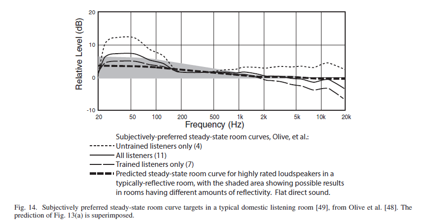

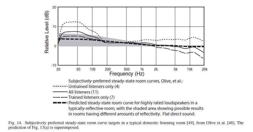

Fully agreed, just thought it may be worth repeating the issue and fixes so new Denon/Marantz users know what to try if they found their bass/dynamic punches disappeared, or got worse after running Audyssey/auto setup.
In my opinion, D+M should cover the Audyssey's flat curve potential issues (some may prefer though I am sure the majority don't) in the Owner's manuals. They are not doing themselves any favor by ignoring this fact, that most people prefer the "Harman curve".
I think Dr. Toole summed it up well here:
(PDF) The Measurement and Calibration of Sound Reproducing Systems (researchgate.net)
You can see why I suggested D+M/Audyssey users to use the App so they can get the "All listeners" curve, like me and Pogre might have.
For "Untrained listeners", the Audyssey Off curce may be just fine, depending on the room/speaker/placement combinations.:D

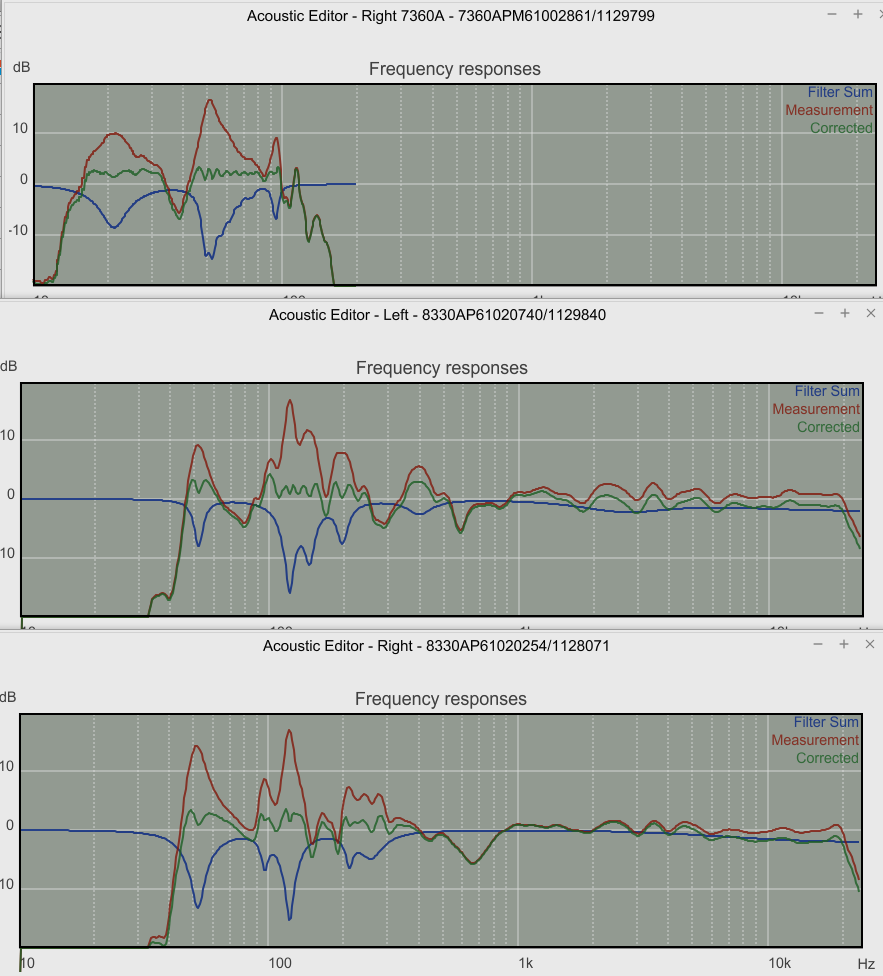

For small rooms some EQ is needed to knock down peaks.
Below is what Genelec GLM AutoCal corrected (it only corrects peaks) in my small office where I sit less than 1m from the speakers. The crossover is set to 95 Hz, and GLM will phase adjust subwoofer with one speaker at the crossover. After calibration I added a HF tilt which is why the blue line slopes down.
The difference is clearly heard, and for the better.
Genelec have now released a new version 4.1 of their GLM software that also have new calibration algorithms AutoCal V2.
One new nice feature is that now one can have a bass shelf filter that increases and that a few of the PEQ can have a small boost from +3 db to +6 dB, depending on the monitors capabilities. The upwards tilting bass shelf filter is not so relevant for my desktop system as I use the dynamic loudness feature of the RME ADI-2 DAC FS, but my wife system could use some tilting as she usually listen at a fairly low volume.
