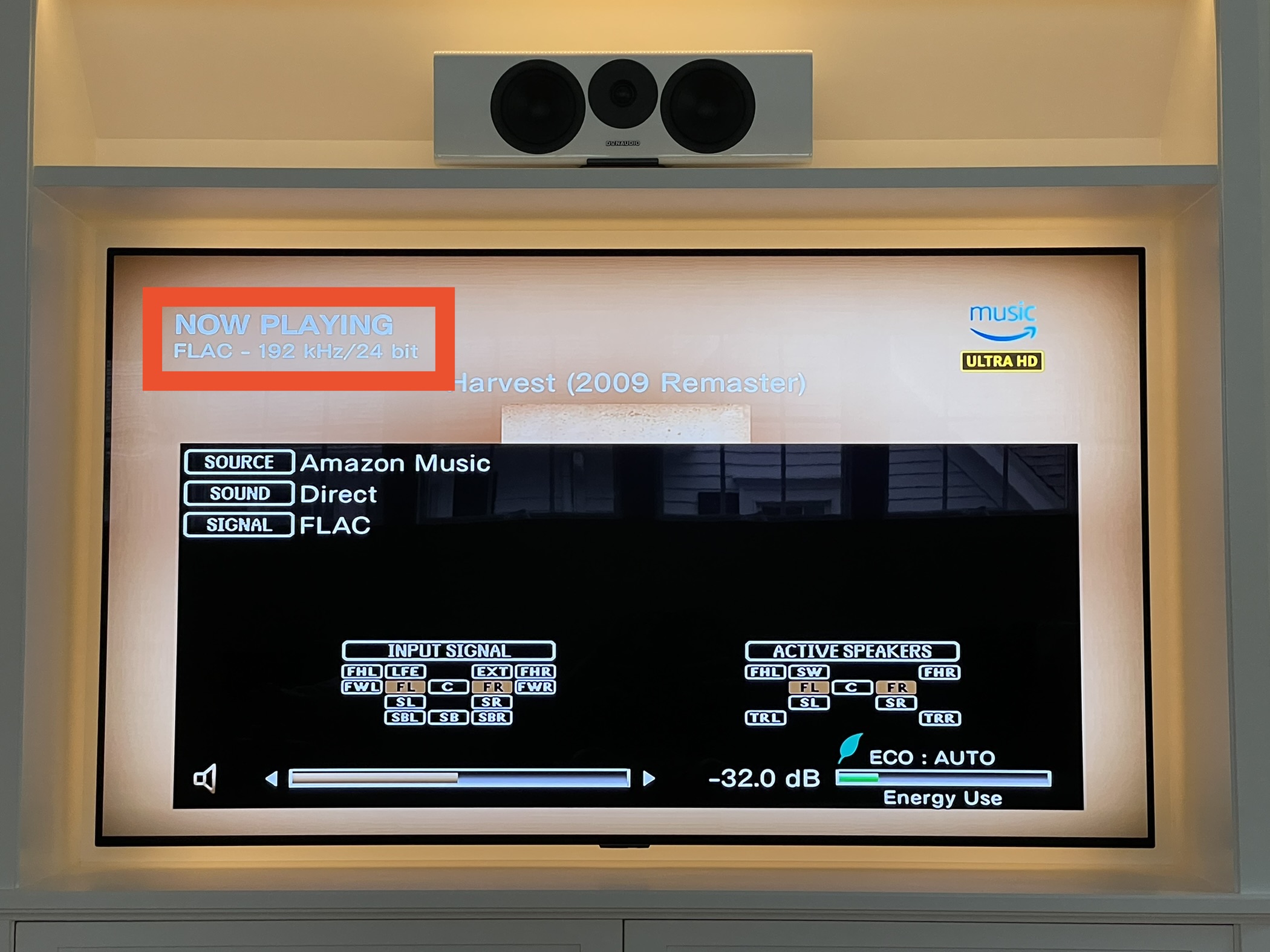

Will the Marantz SR7015 DAC compress 24/192 Amazon Ultra HD streaming music via the HEOS app down to 48 kHz even if I use Pure Direct mode bypassing Audyssey? Same question applies if I use a BlueSound NODE or Cambridge CXN V2 to stream Tidal MQA instead of Amazon Ultra HD via HEOS. Basically, does the AVR’s DAC create a impenetrable wall to 24/192 playback even if Audyssey is disabled? Since there is no way to validate the actual bitrate in the Marantz AVR I guess we will never know?

Isn’t the bit rate displayed on the HEOS screen just the signal rate rather than what is actually being output by the AVR? Also when I click the info button I don’t see a bit rate, only the signal and output formats.

Anyone know of a way to actually confirm the playback bitrate and sampling rate on a Marantz AVR? If the signal says 24/192 in HEOS do I just assume that’s what is being output?
Aside from measurements such as those by ASR, I don't think there is a way, I don't think there is a way because the output signal of the DAC is an analog signal, that is, no more bit depth/bit rate (aka sampling rate) to display anyway.

That's why as you said, it will only display the sampling rate of the input signal.
