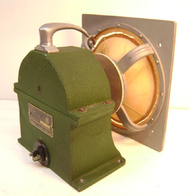

In the early fifties GE briefly got into the speaker business and produced an 8" aluminum cone full range driver, that was quite good, and was used in the Decca corner horn designed by Dr A.R. Bailey and Ralph West.

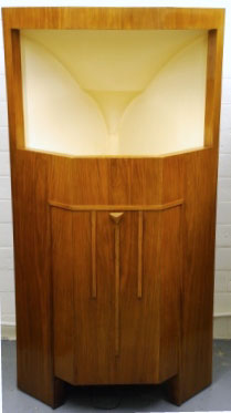

One of these was the second speaker I built. It is actually not a horn, but a folded Voight pipe. It was successful enough that it launched the Transmission line project at Radford audio in the early sixties.
At the same time because of the success of these full range drivers, and the fact that Peter Walker's Quad electrostatic speaker had taken the audio world by storm interest in better speakers really picked up.

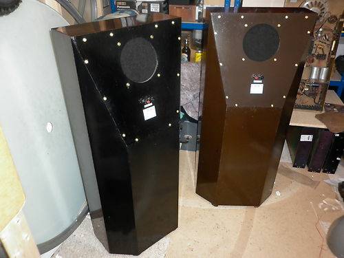

Recently Dennis Murphy has produced a three way design using this novel 3" full range driver from the UK as a wide band mid range.
