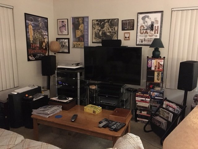

Here's a shot of my listening area. There's a sub below the window on the far left of photo, (the large black mass next to coffee table is junk to be thrown out, the sub is to the left of that junk) and another sub along same wall as TV, below a window on right side of photo. Also a diagram of the apartment, the bedroom area is partitioned from the main listening / viewing area with a bookcase and racks of DVD's. Should both subs be along the same wall as the TV / AVR gear, or along the perpendicular walls?
Apartment size is 505 square feet. 9 foot ceiling.

From the Harman white paper:
If cost and aesthetics are considered, subwoofers at 2 wall midpoints is preferred
