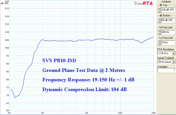

Steve,
I don't know what your opinion of DEEP bass is, but the PB-10 is flat to 20Hz. In room measurements have shown output down to 15Hz +/-5dB.
Ground Plain
In room
2! PB-10s would have PLENTY of output in the low registers, that rarely get used. Plus, his room is 19 by 12, that is well within the PB-10s range.
SheepStar

Sheep said:
Steve,
SheepStar
Sheep,
I should have been more clear. I see you got those graphs from Ed Mullens review. My comparison in SPL came directly from the reviews Ed Mullen did of the PB-10 and the PB12Plus. I never said it would not have plenty of output, I just said that two would not have more than 1 PB12Plus below 25Hz. It's all realitve. I said it was a very good suggestion, and a good option. I was just trying to inform the OP on the choices that's all.
Btw, those graphs don't take into account the amp limited output at 20 and 22Hz which alows it to hit about 94 and 97dB respectively (if you read a little further down in his review it will show the amps limiter will limit the output at those frequencies). Still very good. Compared to the PB12Plus it takes two PB10's to hit that output that's all. And if you put the PB12Plus in 16Hz tune it has output below 20Hz where the PB10 does not. There are always trade-offs and options, like I said just trying to inform the OP.
As far as enough bass for that room, for most I would agree it would be plenty unless they want response below 20Hz (which many do). It may be enough for the OP, and it may not, only he can answer that. Having owned many subs, including a 12" SVS, for me the 2 PB10's would not be enough even in that size room. Then again, I'm a basshead. ;) Different strokes.......
