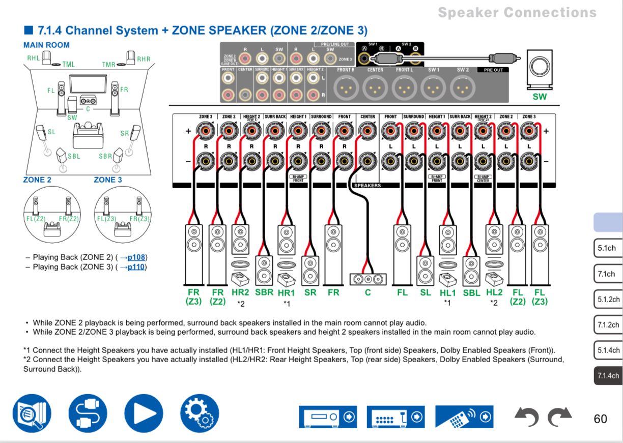

I am running 5.1.4 with my FR/FL bi-amped on the Integra DRX-8.4. There's no benefit to bi-amping them, I just had an extra set of amps left over since I am not running 7.1.4 or 5.1.6. I don't use multiple zones, but it is possible to run 7.x.4 with Zone 2 & 3. See page 60 here:
No bi-amping with that configuration, but passive bi-amping is pointless anyway:

The DRX-8.4 has eleven amps. Running Zones 2 and 3 knocks the Main Zone down from 7.1.4 to 5.1.2. The Denon A1H has 15 amps and can run the Main Zone at 7.1.4 when running Zones 2 and 3. This is the case when neither receiver is bi-amping the front channels.
Ah yes, my assumption was that zones would not be run concurrently...
