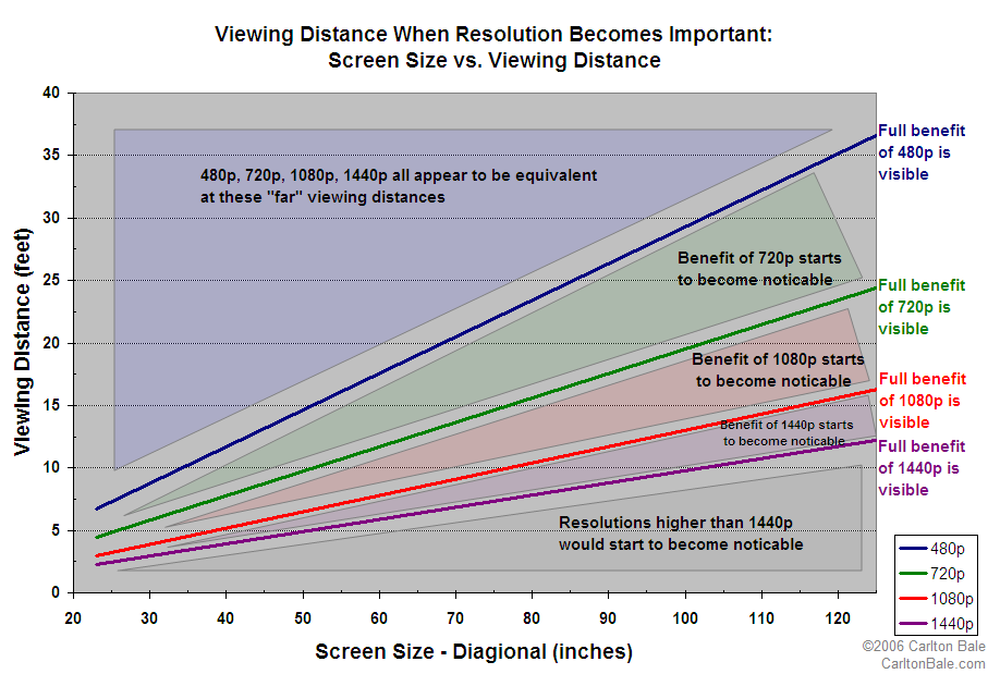

I am building a media room. I have read as much as I can about proper viewing distance, but I still cannot figure out how to calculate the appropriate viewing distance. I will be viewing a 130"W x 55"H screen for 2.35:1, which results in a 41-degree viewing angle, masked to 98"x55" for 1.78:1 (~31 degree viewing angle) and 73"x55" for 1.33:1 (~23.5 degree viewing angle). My viewing distance is 14 feet. I plan to use a front projector with an anamorphic lens on a sled, with a Realta-driven video processor. The screen width is maxed out, and the viewing distance is fixed. The graph above suggests that I am slightly too close, but in the ball park. Will I see artifacts ? My more critical question is based on the range of sources I will have: Blu-ray playing 1080p & 480p DVDs, DirecTV HD & SD, Time Warner NYC cable HD & SD, FIOS, OTA HD, Media Center, all going through the Realta processor. Isn't the answer that the viewing distance is source-dependent ? Is ambient light a factor, or are you assuming a blacked-out room ?
Re John's article, it begs the question re what is the proper viewing distance for a 50" 1080p plasma.
If the graphic I posted is right, it's about seven feet to take full advantage of 1080p, but you'd start to notice an improvement over 720P as you get closer than 10 feet. (assuming 20/20 vision if I recall)

all this talks about how far away you can sit ... what about: how close can I sit?
e.g. can I sit 8 feet away from a 100" screen?

Why not? I think that would probably give me a headache but that graphic will tell you what you'll see.
I think sitting 8 feet from a 100 inch screen is about right with 1080p closer and youll probably start to see pixels but if your sitting closer youll probably get sick first.

Mine falls right into the "benefit of 1080p starts to become noticable". Which sounds about right, because I have noticed differences between 720p and 1080p video (of the same source). While I can't necessarily make out more "detail" on the 1080p picture, it just looks overall sharper. When watched back-to-back, the 720p looks just a little soft by comparison.
That's what I see, anyway.

Anyone want to hop in the way back machine with me to bring back up this article and how it relates to 4k UltraHD? ;)
You might want to look at the calculator here and the chart and simplified calculator here. Here is the chart:
One thing to keep in mind is that they are based on having 20/20 vision. If you have worse vision, you can sit closer, and if you have better vision, you will want to be farther away than what is indicated there. But for someone with 20/20 vision, sitting only 8 feet from the screen, one would need a TV larger than 61 inches in order for it to make any difference whether one had 1080p or anything with higher resolution (like 4k). And if one is 10 feet away, one would need a TV larger than 76 inches for 4k to matter instead of having 1080p (again, assuming 20/20 vision).
The upshot is, for most people with the size TV and viewing distance that they have, 4k will be completely irrelevant. But many of them will buy it anyway, because when they are 3 feet away from the screen at the store, they will be able to clearly see the difference between 4k and 1080p, but then they will put it so far away from their viewing position that they will have completely wasted their money on the higher resolution. But people have long wasted money in their choices of AV systems, often spending too much on amplification and too little on the speakers, and thus they have inferior sound to what they could have had for the same or less money. But any fool can tell that 4k has more detail than 1080p, and that 120 watts is more than 100 watts. The thing is, often those are not differences that will matter in actual practice, depending on all of the other circumstances involved. And some of the things that matter are hard to quantify (like better speakers), and so people often don't take enough care with those things that make a real difference.
