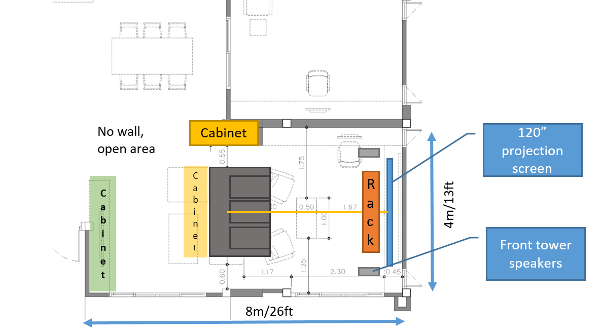

Hi,
I'm building a new music room/ home theater/ living room area with quite long room. It will be around 4x8x2.5 meter (13x26x8 ft) with open area in the back.
I plan to setup in 5.0.2 where LCR is box and floorstanding. However, I will have to do all in-ceiling for both Atmos and surround/rear surround speakers. Will this work or should I go for other configuration? I can technically use box speaker on green cabinet for rear surround but it will be very far from listening position and maybe artistically challenged :p. The system is intended to be primary for music, but occasionally home theater. No subs are allowed (yet).
I haven't got the new AVR yet but I already have a vintage power amp (MC2105) and few vintage NHT speakers, VT2.4 for fronts (which maybe upgraded later), VS2.4 for center, SB1 for surrounds (likely to be replaced by some in-ceiling solution, not decide yet).
Please recommend.

You might want to put painter's tape on a wall in the shape/size of the proposed screen and sit at the position you show- that's a big screen at that distance and it might be too large.

Thanks. The seating position is quite fixed to around 13ft from screen due to the corridor behind it. However, I haven't got the screen yet so I will definitely try to project on wall and will get smaller 90-100 inch screen if we feel it is too big.
What I'm not sure is how much I lose for using in ceiling speakers for both atmos and rear surround...

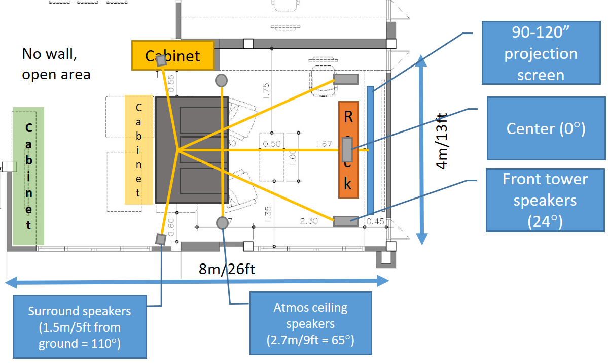

1. Put rear surround speakers at near-ear-level on the green cabinet (they will be slightly off-center and will be a bit far from usual seating position).
2. Run 3.0.2 Atmos, while Dolby recognized this configuration, I'm not sure if it's worth over typical 5.0 or not. However, I need different locations for ceiling speakers between those configs.
3. Run 2.0 and forget Atmos. Get better front and maybe new DAC.
What do you think?

What ever you do do not have surrounds anywhere that is too high. Dolby specifies 1.2 to 1.5 meters off the ground. If your unwilling to do so for the best and most accurate Dolby atmos setup. Find another room.
I have a no tolerance policy towards speakers in the ceiling except for Dolby atmos and dts x height speakers.
Dolby atmos for home theater guidelines pdf is where you start before you decide on placement and it helps to know this before you build a room to place speakers and plan accordingly.
Focus on the angles and not on the diagrams as they can be misleading.
i have given the side surround speaker placement as per 90-110 degrees to the listening area with a diagram with squares to show where they should be placed one is 90 degrees and the other 110 degrees so somewhere within the two is fine.

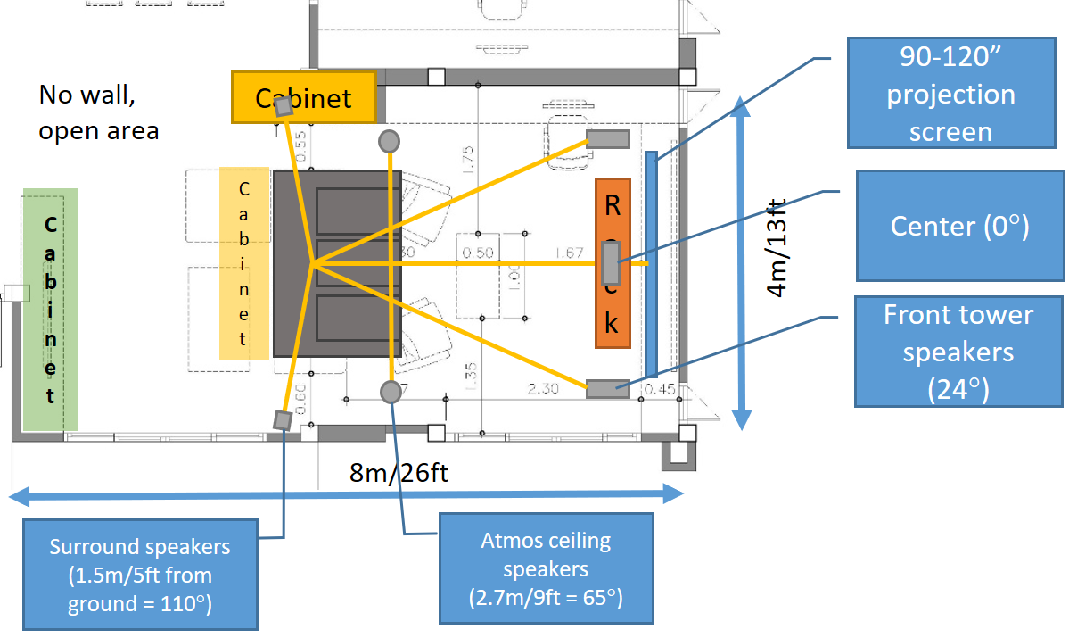

Thanks! I think I found a good placement based on your recommendation. This should be aligned with Dolby specs. :)
W
Wardog555
That placement is heaps better. Hope you will get a subwoofer one day!

Another thing to note that where it comes to the height speaker placements. You don't want them too close to the walls. It's not a requirement that it lines up with the front speakers as shown as in the diagrams.
I put mine at room width divide by 3 and used that as placement guide. But ceiling batens in the way so I moved them where they could fit.

Imo it’s worth going for .4. Where a problem could be, is if the LP is up against the back wall. That doesn’t leave room for 45° behind for height/top speakers, so imo .2 is smarter.
If I read your picture right, I’d go .4.

Behind listening position is open space. However, the problem is I have no space for push bed surround further back (due to open space on the left and sliding glass door on the right).
So, if I go .4 that means my rear atmos speakers will be behind the bed surround for 45 degree. Otherwise, the rear atmos will be just above listener head.... Not sure if I still can go .4...
