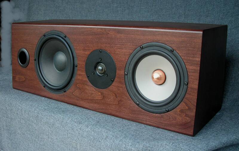

I've been looking around, but haven't found a lot of information on a WTM center channel speaker. I was just looking for more information and opinions on this style, pros, cons vs a more traditional arrangement.

That looks like something from Source Technologies.

That it is. John is the only guy I know that has a center speaker which looks like a MTM, but is really a WTM. I'm going to ask him when I go over to his shop sometime in the next couple of weeks, but I thought I could pick some brains on here before I see him.

I'm curious about the center because my HT no longer uses the Phil's so I'm curious how a matching center would sound, then I'd have an all Source HT system.
Your biggest plus is that they are from the same designer. However that does not mean they will always match as a lot of brands have speakers that sound totally different as you go from one model to the other.
But to answer your question WTM it is a really bad idea. MTM is bad enough, and I would never do it, but this will be worse. The problem is lobing error. The dispersion will be such that ceiling and floor reflections will be maximized to exaggerate room defects. The crucial horizontal dispersion will be lumpy bumpy, and it that design extremely so, as well as asymmetric. That is to say the left lobe will be different form the right lobe.
I had a quick look on that guy's website and he seems to have some other designs that are absolute non starters.

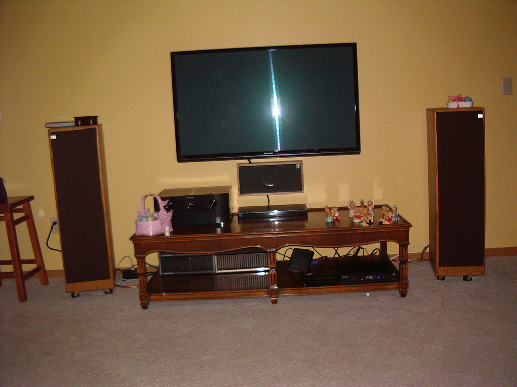

I just built this 4" JW driver from scratch for the center at our Eagan home. It is full range and BSC, what little it need as it is wall mounted is built into the cone.
So the single cone is connected directly to the amp.
It is really natural and my wife, an excellent audio critic, loves it. It has natural speech with excellent speech discrimination at very low volumes.
Audyssey crosses it over to the isobarik subs in the R & L mains at 90 Hz, which is correct. The unit is sealed, and by the way, I think a center speaker should NEVER be a ported design. So since it is sealed it is second order roll off, so the acoustic and electrical crossover is composite fourth order.
The 4" center speaker is 8 ohm, the mains are four ohm. However the sensitivities of the 4" unit and the drivers in the mains are virtually identical. However the Audyssey settings showed the single 4" cone to be 3 db more sensitive. So you can see how even a low part count crossover in the mains, consumes half the amplifier power. So the center only takes one quarter of the amp power the mains do for the same spl.
It really holds its end up on music also. I played the Mahler 8, that has a large number of soloists at a volume I was afraid might garner complaints from the neighbors. The unit showed no sign of distress. It blends with the mains perfectly.
This will get me into further refinement of this driver. This is technology from 1959 that has been wrongly ignored and not further developed which is a tragedy. Although I have to admit, the cone is very expensive to manufacture. However with modern techniques may be not any longer.

I think a center channel is far from essential. On my big rig it is difficult to tell if the center is on or off. I do think there is an advantage for movies. I think the dialog is better preserved in the loud action scenes.
I do like to use the center alone for historic mono recordings. Mono sounds better through one good speaker rather then two.
This rig has no center.
Speech and localization are excellent. The speech discrimination band is handled by Dynaudio D76 dome mid range drivers crossed over at 400 Hz and 4000 kHz. So there is no crossover in the speech band. Center fixation is excellent even when the rig is listened to by the fire place way left of the left speaker. I spun a lot of vinyl listening by the fire place this winter.
On the rig with the 4" full range driver, I think speech discrimination for movies and TV has been improved, especially at low volume. Those drivers are quite exceptional and you would never guess you were listening to one small full range driver unless told and even then you would be incredulous.
