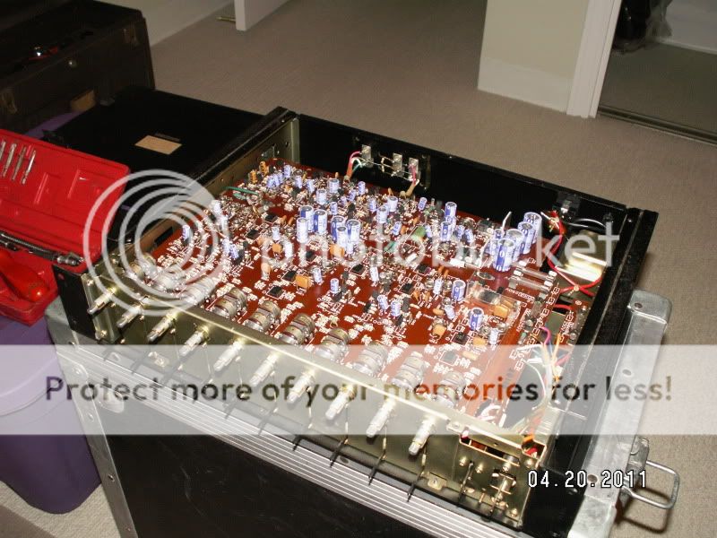

I just came to realize that this EQ I have is producing a hum and I'm not sure what to do with it.
The b!tch of it is that I just got through giving it the love. :(
... after the love
The good news is that the amp is clean! I had previously suspected it of being dirty. :)

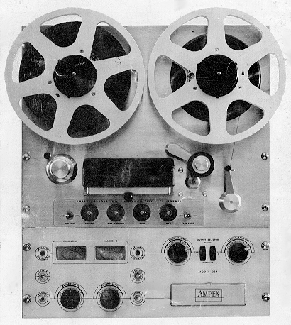

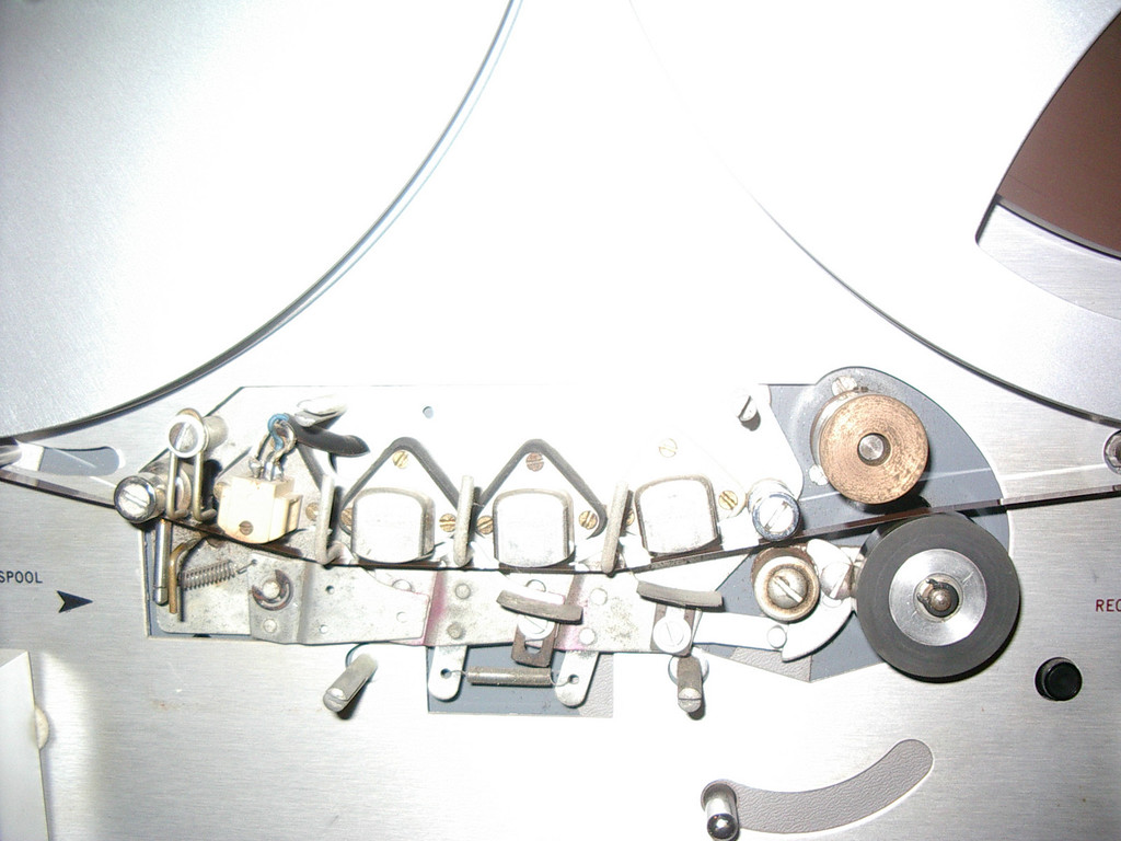

Dave, can we have more pictures? In particular pictures of the head block are vital I think the deck is a 300, but I'm not certain.
I think you have a 300 deck with a 354 preamp. That would put it circa 1960.
If it is the 300 deck it would be two track stereo. A few had four track play back heads as well as a two track one.
Now I suspect your relative had the Concertone to play the prerecorded four track tapes. The question is, are those tapes you have marked as two track or four track? The issue is important as most likely the Ampex is two track only (tape only goes one way). The Concertone is almost certainly four track (tape turns over and goes both ways)
As far as value. I can't find a sale of the deck which I think is a 300, but the 354 preamps fetch around $300 sight unseen and around $700 fully restored. The 300/354 combination was aimed at the radio station market. The 354 was apparently known for overheating problems.
Both were made at the Ampex Redwood California plant.
I have searched for anybody that might have circuits or service manuals for those items, to no avail. I can find the Eq circuits for the 354.
What do you want to do with these units? As far as I can tell the deck seems quite rare now, there are a few 354s most in bad shape. Both of these units should be restored and preserved if possible.
If you want I can talk to the Museum of broadcasting and see if they would want those units as a gift. I would be happy to assist them with restoration. As you will see they have some fine exhibits. Pride of place is a huge Western Electric cinema horn speaker. This was the forerunner of the Altec Lansing speaker company, and the ancestor of the Voice of the Theater.
You have inherited an important enough item that it should be taken in hand.

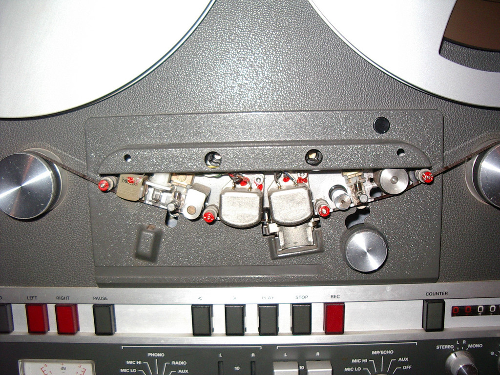

Here is the head block of my two track stereo Revox A 700, (in Europe referred to as half track), recorder.
The small head to the left is the erase head. The head in the middle is the record head, and the head to the right the playback head. This allows for off tape monitoring of a tape as it is recorded.
This is the track format.
Now here is the head block of my Brenell Mk 6.
This machine was built especially to my specification. Note there are four tape heads.
Form left to right, 2 (1/2) track erase, 2 (1/2) track record, 2 (1/2) track playback and then that extra head 4 (1/4) track erase. So this machine will record and playback 2 (1/2) track stereo tapes, but can also playback 4 (1/4) track stereo tapes.
This is the track format for 4 (1/4) track stereo tapes.
Then we have the issue of equalization. North America used NAB curves, the UK had CCIR and continental Europe largely DIN. CCIR and DIN curves are close, but NAB very different. All my machines are NAB.
Now speed, reel to reel machines have various speed options. Speeds are 1 7/8 inches per second, speech quality. 3 3/4 ips often used on consumer grade machines, but below Hi-Fi quality, 7 1/2 ips much better quality and what most of us used to use for recording from radio. Most pre recorded reel to reel tapes are 7 1/2 ips 4 (1/4) track stereo. Older ones before RCA invented the 4 (1/4) track stacked stereo head are 2 (1/2) track stereo. These are sought after and sound better than the later four tracks. These are hard to find. At 7 1/2 ips you can not get to 0 db full modulation out to 20 kHz and have to calibrate the machines at -10 db. So there is HF saturation and fall off in HF response.
So for professional recording we all used 15 or even 30 ips2 (1/2) track. At these speeds you can fully modulate a tape to 20 kHz and down to 20 Hz. So you calibrate the machine at 0 db. The problem is that a 10 1/2 NAB tape reel only last 30 min at 15 ips and 15 min at 30 ips. So you have to switch from one machine to the other at the recording session and have the machines very closely calibrated. This is also very expensive. Good master tape was never cheap. I used to switch between my Brenell and Revox A 700
Now we get to the next incompatibility, noise reduction. Reel to reel tapes for pro use can have Dolby A and dbx 1. There were also a few others such as the Telefunken system.
On the consumer end there was Dolby B and dbx 2.
If you go back to the early to mid fifties, the right and left channels were on different heads, so called staggered head stereo. The problem was that there was no agreed head spacing and every manufacturer used a different head spacing! I have one staggered head pre recorded tape in my collection, what I call the museum.
All of this gives the tape collector a wonderful excuse to have a lot of machines!
The machine on the left is 4 (1/4) track stereo. It is a Revox A 77 Mk 4 and has Dolby B available to it. Speeds 7.5 and 3.75 ips.
The next to the is the Brenell Mk 6 2 (1/2) track stereo record and playback plus 4 (1/4) track stereo playback. dbx 2 noise reduction available. Speed 15, 7.5 and 3.75 ips.
The lower machine a 2 (1/2) track Revox A 77 Mk 1. Speed 15 and 7.5 ips. Dolby A noise reduction available.
The machine to the far left is a Revox A77 Mk 2, 2 (1/2) track stereo machine. Speeds 15 and 7.5 ips.
The Revox A 700 2 (1/2) track stereo recorder. dbx 1 noise reduction available. Speeds 15, 7.5 and 3.75 ips.
So that is an excuse (really need) for lots of machines. And you think we have compatibility problems now?
For Dave's machines his Ampex will be 2 (1/2) track stereo 15 and 7.5 ips.
The Concertone will be 4 (1/4) track and have speeds of 7.5 and 3.75 ips and may be 1 7/8 ips.
So I would be certain there are tapes that play on one machine and not the other.

I tried to get some good shots of the heads but it's hard with the door that's covering them.
This thing is a beast. It's too heavy to remove from the box but this may show it's cosmetic condition better.
Here are some photos of the other piece.
Thanks Dave! Those pieces do seem to be in fine order. I wonder what the speeds are. It has tow speeds. I wonder if it is 15/7.5 or 7.5/3.75. Since they were for radio stations, I bet you could order them either way, like the Revox A 77 which was the backbone of radio stations around the world.
