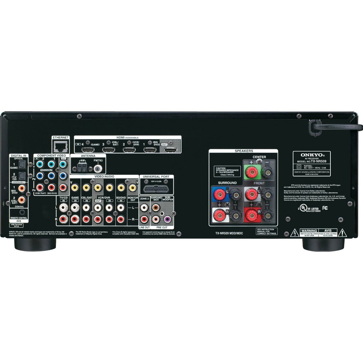

I'm thinking the 6mm cable is designed for an amp with XLR connectors. My amp is a low budget here is the spec.
Amplifier
Power Output
Front L/R 130 W/Ch
(6 Ω, 1 kHz, 1%, 1 channel driven, IEC)
Center 130 W
Surround L/R 130 W/Ch
Dynamic Power 180 W (3 Ω, Front)
160 W (4 Ω, Front)
100 W (8 Ω, Front)
My Speakers are bookshelf with 100 W/Ch (i don't know if this changes
anything)

Thanks Guy, I decided on the 'Van Damme Professional Blue Series Studio Grade 2 x 2.5 mm' which according to Amazon is 13AWG as well as these.
