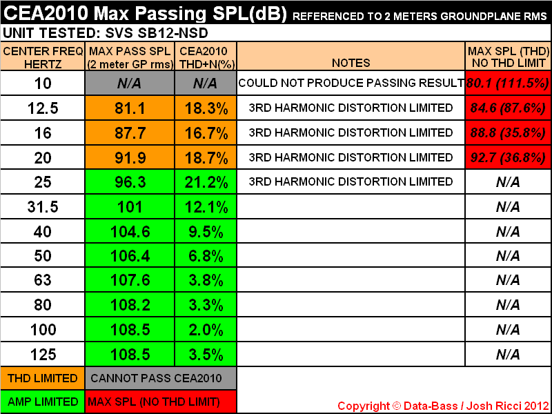

The SB12 is pretty good- for a small sub. But if you can accommodate a larger sub, you can get more performance for the price. For music, for a medium large room, in that price range, I would be looking at the Hsu VTF1 or the Premiere Acoustics PA-150. The VTF1 is a little beast in the music ranges, hitting 110 dB from 40 Hz and above in 2 port mode. The PA-150 is averaging 115 dB at 50 Hz and above, very powerful for music ranges. The RSL Speedwoofer looks to be only slightly more powerful than the SB12: RSL measurements vs SB12 measurements.

A single VTF-2 will dig deeper and have more output, but it will have a rockier frequency response than a system with two (well-placed) subs. If your primary concern is extension though, it will be much superior to a pair of any of these $400 subs. It does dig down to a solid 18 Hz, whereas these other subs tap out at 25 Hz on a good day.
