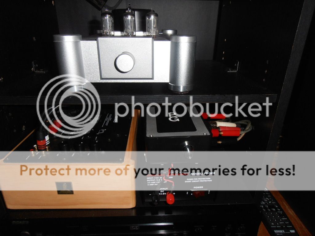

I've always had excellent results using tube preamps with ss and class D integrated amps. The accepted practice is to max the pot on the integrated amp while using the preamp to control the volume.
In this picture I'm using the silver Nobsound 12AX7 preamp paired with the $10 TPA3116 integrated amp and a $22 Pyramid regulated power supply ( lower right ).
Haven't seen any posts here on the incredible TPA3116 but on other forums it's all the rage.
