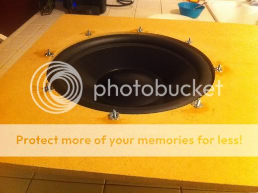

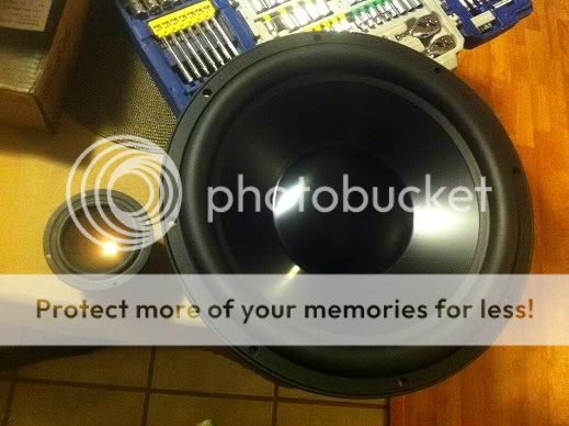

Well, curiosity got the best of me and I had to build one. I've read a couple of different reviews for the Tuba HT by Bill Fitzmaurice and the conclusion is that this thing is a monster in almost every sense of the word. And since I had a week to myself while my wife was out of town, I took the opportunity to build it. There are videos showing the THT playing 121db at 22hz! Although I haven’t measured it yet, I believe it.
Currently, I have it hooked up to my EP4000 running through a DCX2496 (running the settings for my Simple12" Kappa Perfect). I will sit down and properly EQ this at a later date. The THT doesn't need an EP4000 by ANY means but it's what I have. Supposedly, 150 W is plenty. I've only listened to it for about a day so far, throwing various music and movie scenes at it, and the settings on the equipment is not ideal for the THT but nevertheless, there has been NOTHING that I have thrown at it that it hasn't taken like a champ. I have not been able to get it to distort. I have, however, found new rattles all over my house that were previously hidden. It’s just endless and there seems to be no bottom to this thing. In its current state, I think the sub gives up a little detail when listening to music but the raw output just amazing, so worth it! I think Matt34 and wormraper can back me up on this one.
It is a little on the hideous side with its size and boxy shape so if one could hide it either in the attic, crawlspace or as a strange looking bar in the back of the room, it would be ideal.

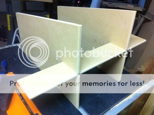

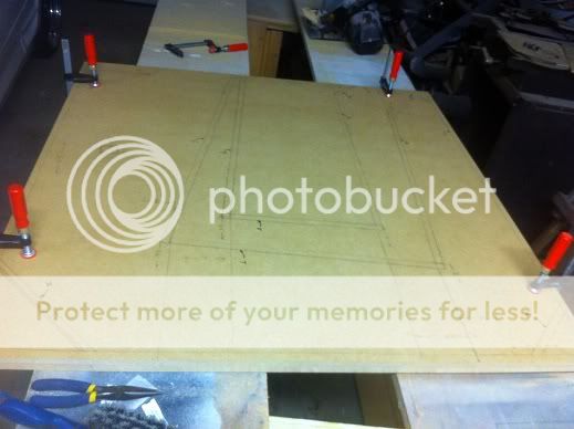

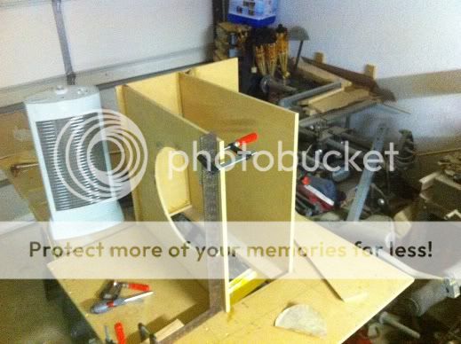

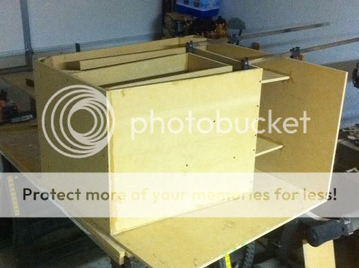

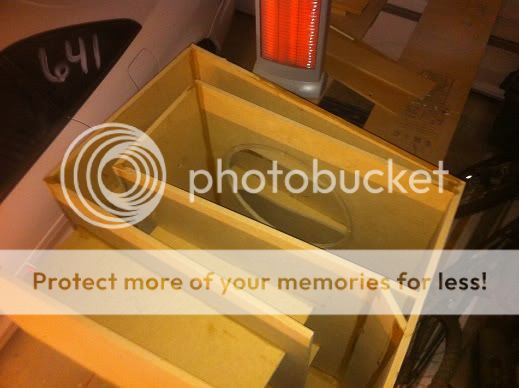

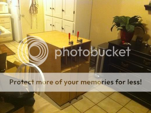

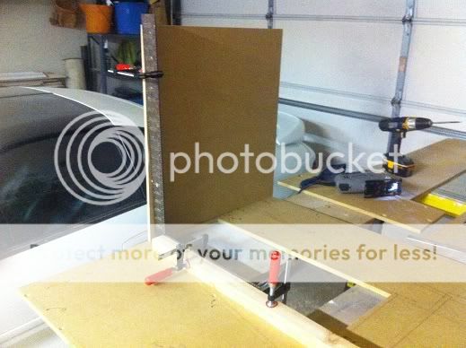

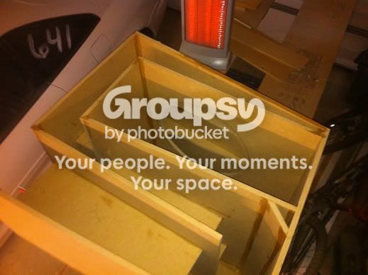

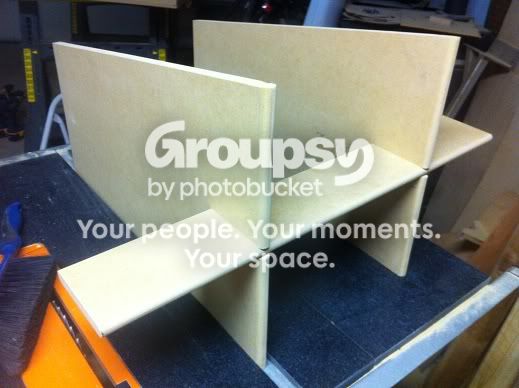

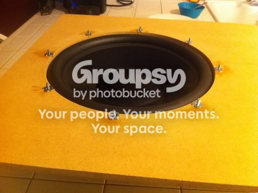

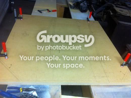

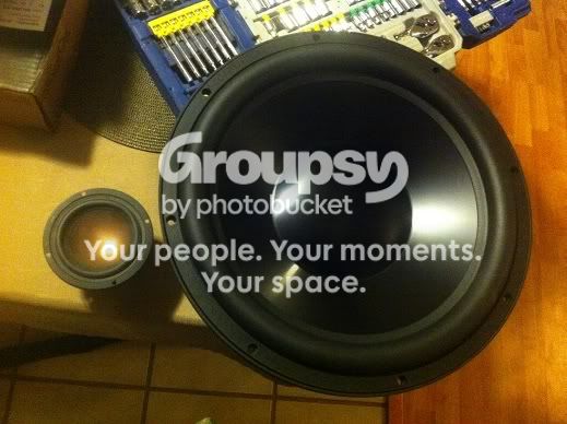

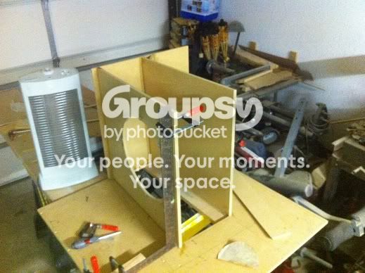

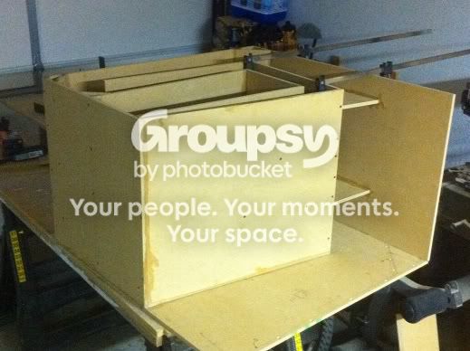

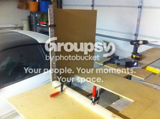

I just can't get over this thing. It’s like it just doesn’t care what it has to play, it just plays it. And to think that I’ve got $170 in the driver (which is the more expensive option) and about $70 in materials, I’m not sure you can beat it for the money (or at any price). Here are a couple of pictures of the construction and unfinished box. If you have a weak stomach, you may want to look away now, it's still just raw wood.

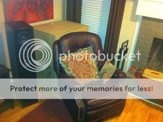

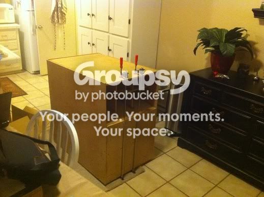

This is my attempt to hide this beast so the wife wouldn't notice. (it didn't work by the way, I even put a plant on it)

Those are some really good looking pillows. Maybe Erin can put up a build thread with a few pic's. :D
That thing's as big as the chair, dude ... and that chair ... well, it's been a good friend over the years. :)
Hahaha! Look at those dweebs! Where did you dig that picture up? The teeth marks really show up on my picture. Apparently I did that when I was teething. Dad wants me to keep it around so I can take a picture with my kiddo doing the same thing. Oddly enough, he's still got the rocking chair and picture in the background.
