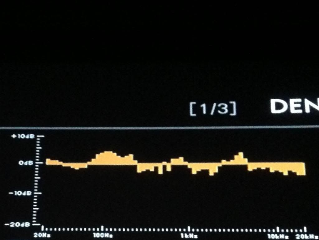

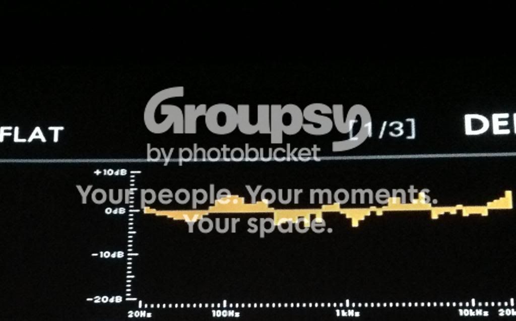

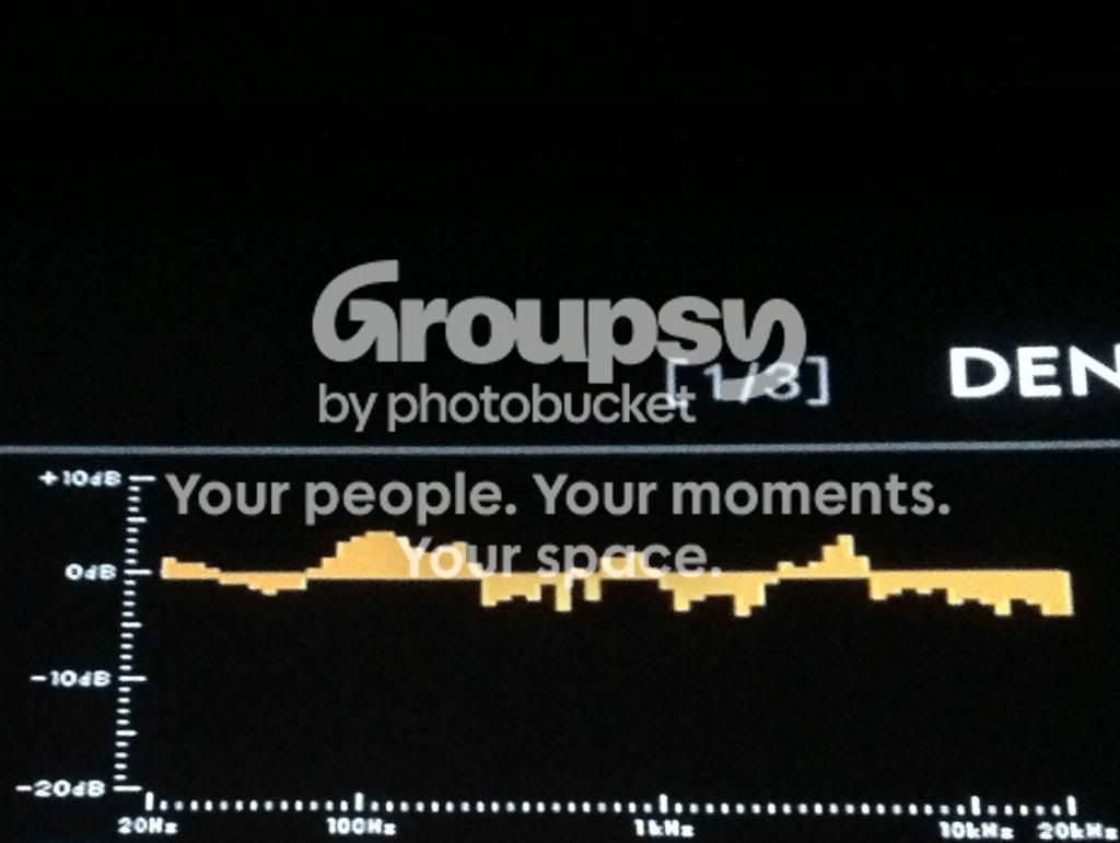

Just ran Audyssey today on AVP-A1 + KEF 201/2. I liked FLAT better. I guess I don't like HF roll-off like I am supposed to.
Audyssey Flat (no HF roll off):
Audyssey (HF roll off):
