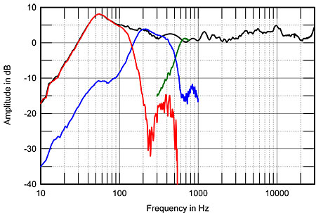

2 of the drivers have breakup that is not attenuated enough.

No they do not. For one, the red trace is the port. Might want to study the measured data a bit more. It's an excellent performing speaker.
Fig.2 Magico Q5, anechoic response on tweeter axis at 50", averaged across 30° horizontal window and corrected for microphone response, with nearfield responses of midrange unit (green), upper woofer (blue), and lower woofers (red) plotted below 750Hz, 1kHz, and 550Hz, respectively.
The single impedance peak in the bass in fig.1 indicates a sealed-box alignment for the bottom two woofers (which behave identically) tuned to a low 29Hz. The red trace in fig.2 shows the output of these drivers, measured in the nearfield.
Four-way, sealed-box, floorstanding loudspeaker.
You were saying?
