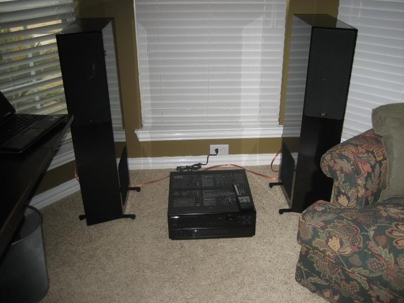

Here are the speakers I got for him. This is just a picture of them in my office "testing" them out before I gave them to him.
