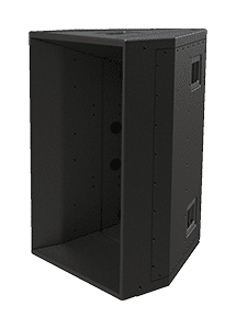

Pick something from here
everettT
everettT
Unless you step up to speakers like Danley or to a lesser degree JTR, you'll never get the output you think you want. But as mentioned by others, why would you want speakers that can handle 125db in a home environment unless you're specifically looking for hearing loss.
I'm pretty sure these aren't what you need or want unless you have small stadium in your home.
