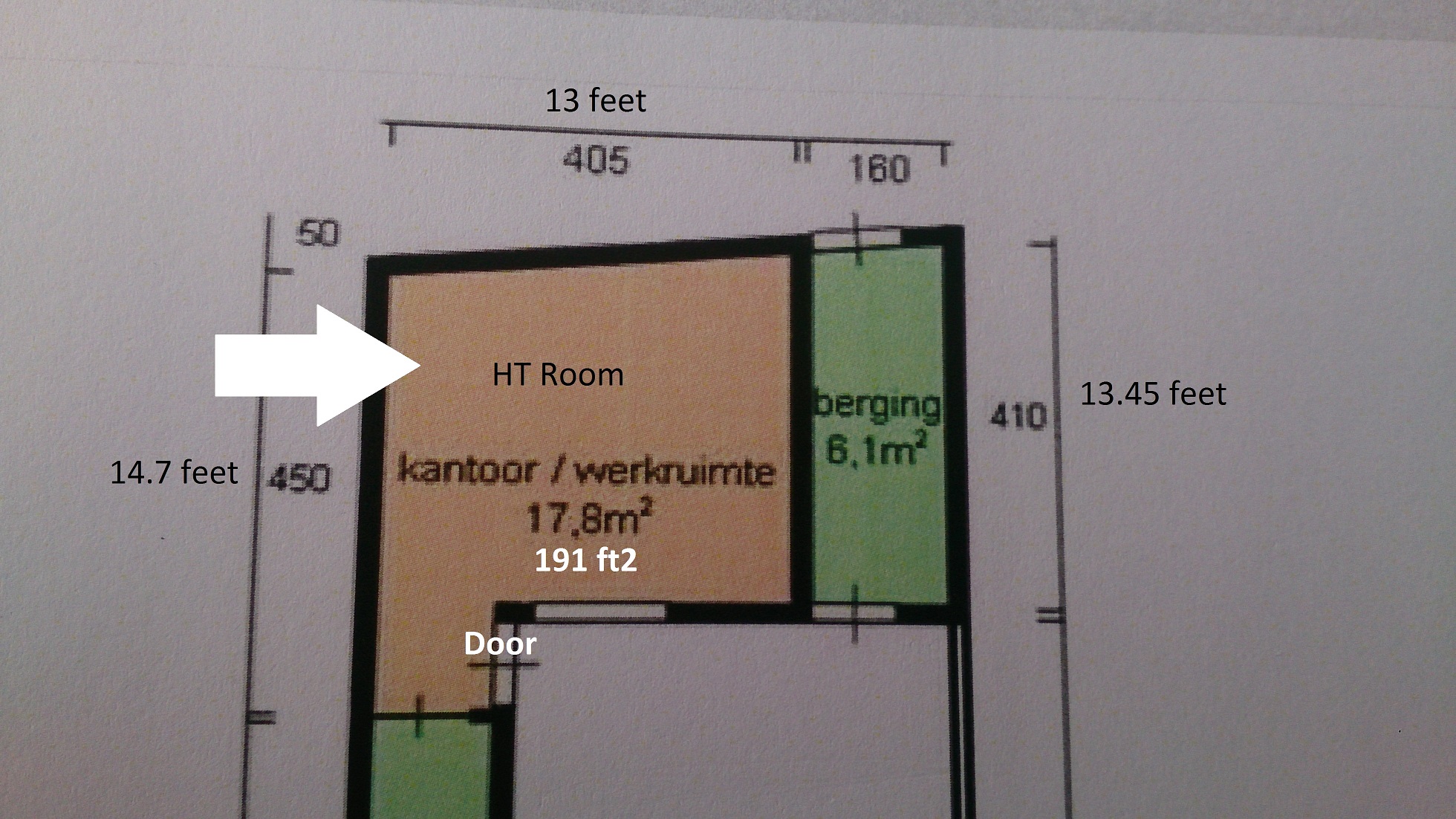

Picture is the floor plan, and how it looks now.

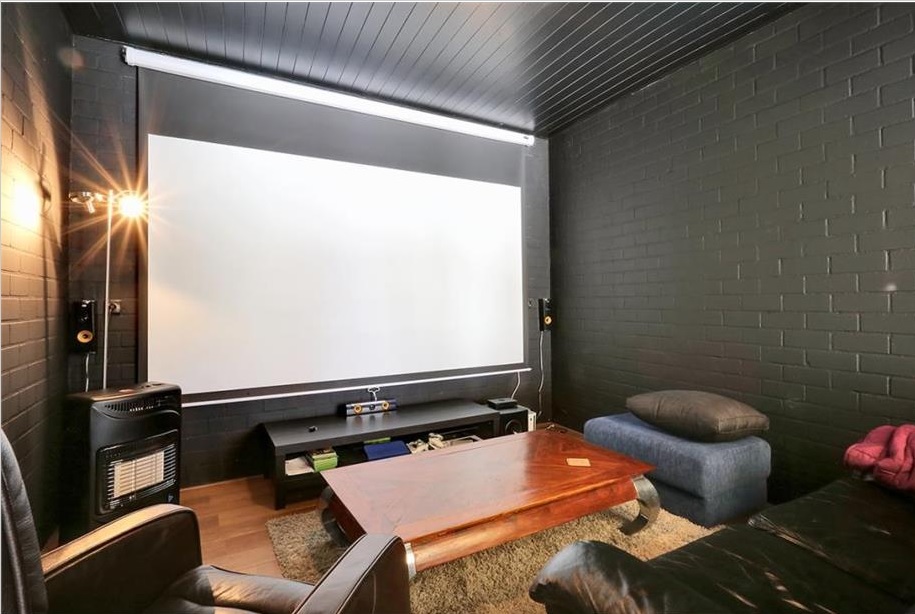

It is always the case that front projection is fun, there is also almost always room for improvement.
In this case, it looks like the paint isn't a flat paint, but somewhat glossy, which is reflecting everything like crazy. I would probably go through with a dark flat paint. Even one with some color in it, as long as it is flat, will do a better job controlling light bounce from the screen.
I'm not sure about the screen at all. Why motorized? It doesn't look like there needs to be access behind it, and you can already see that there are some waves in the material. There may be a reason for it, but a fixed frame screen is a far better way to go. It will not have waves, won't develop waves, and the screen border will actually do a better job in controlling any overspray of light around an image.
The light at the front of the room is okay, but should never be on, even at a low level, when the projector is in use. If you want some lighting on while the projector is on, use directional spot lights back towards the seating area, directed away from the screen, and on dimmers.
No idea on the projector which is in use to know if that's all good or what the deal is there. The room itself seems like it is a really good space to just kick back and enjoy. I would probably look for a dark carpet solution as well in there to help keep reflections at bay. Especially some softening to the walls as that's gotta be a crazy bright room.
I guess if you just bought all this stuff, and hooked it all up... then my biggest comment would be to ask why you are asking now instead of before you bought anything? Nobody's approval or suggestions matter much after the fact. The time to ask is before you buy anything so comments can be made ahead of time.

This is how the current owner has his setup, I will be moving in in December.
I kinda regret posting this post since I can't go in and measure or do anything.
I was just asking in general what people think about the space, how to best set it up and maybe some projector and screen advice.

Hey! Don't regret at all. I hate when people ask after they've personally dumped cash into a setup they are excited about, but they never did any research before they bought, then want opinions after.
If you aren't in yet, then you are asking now, before you are in, and you have a lot of time to make some considerations and let others think and respond. Are they planning on leaving that home theater setup as it is, or are they taking it with them?
Obviously, if they take it, then you are starting from scratch, in which case, you have a lot of questions to ask, and answer.
The first, and really most important (IMO) is establishing a budget for what you intend to do.
I would plan on painting. Keeping things dark as is already established, but make sure you go with flat paints. It looks like you could throw a fixed frame screen up for not a lot of cash. Something like a 120" diagonal or so, which can be decided upon later. Same with the projector really. You don't need to decide upon that until you know where cabling is, and what's there already.
I would focus on what you just asked about. Getting acoustics under control, and that question may be better served in the speakers and audio sections rather than the projector sections. Show the photo, let them know that you are buying the home and that you intend to rework the room as appropriate.
From there, you should get some good ideas on how to get the best audio performance from a 5.1 or 7.1 audio system. I would certainly make sure all wiring is hidden as best as possible, I would pick an equipment location that is OUTSIDE the room. The room is small, so having all your gear inside the room isn't the most convenient if it can be avoided, or in a small rack on the opposite end of the room from the screen. Covered so light doesn't spray onto the screen.
There are a number of ways to soften walls, but I haven't been in a room like that with concrete/brick surfaces everywhere. It's nice looking (IMO), but definitely appears cramped, and I wouldn't think the acoustics are good. It would likely get to sounding bright (shrill) very quickly. So, there are wall treatments which can be used. Nothing is really required for the ceiling, but there is stuff out there. I always use carpet in my theaters as a major absorber. Which is a shame with the nice hardwood, but perhaps a very large area rug with good padding would help.
If you aren't in yet, and you are buying this place with an intent of long term ownership, then just use this time to come up with ideas to make it all happen and be as awesome as you want it to be.

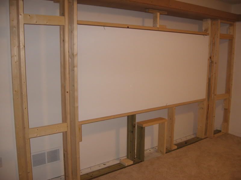

What is the best solution? I will be making a screen frame something like this:
(this is a 8' 2.35 screen in a similar size room as mine.)

If your budget allows, there are screens which are fixed frame which have magnetic 'masks' for them. So, you build a screen section like what you see above, and then you put in a 16:9 screen. When you have 2.35 content, you just snap the masking panels in place to frame down your 16:9 screen so it appears as a 2.35 screen. You don't change the width, and you maximize your width for the space. But, when you have 16:9 content (HDTV, 1.85 movies) you pull off the masks and maintain the same width. The inclusion of a masking system adds to the pop of your setup, and eliminates the 'visible' black bars. Understand, there are ALWAYS black bars because that is part of what the 16:9 projector actually projects, so having dark velour masking in place makes those black bars just disappear completely.
I'm not sure who all makes magnetic masking systems, but I know that Seymour AV does...

Thanks! yeah been browsing around and I found home made magnetic masks.
