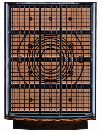

Most ESL speakers are dreadful beamers. That is because all frequencies are radiated by a large diaphragm. Peter Walker of Quad is the only guy who ever cracked that problem in his ESL 63. This was solved with delay lines within the diaphragm.
If you like electrostatics then Quad are the best performers.
I recently upgraded this Quad system for someone. I had not heard the Quad ESLs for some time and was stunned once more how good they were.
dlaloum
They can also be purchased quite economically (used... with some sets dating back to the early 80's!), and parts for their maintenance/refurbishment are readily available...
They do however (like most ESL's) require a bit of "breathing space" for best results.At one stage I ran a 4.0 surround setup using a pair of ESL989's front and a pair of ESL63's rear.... I still miss them... domestic peace and space requirements forced me to replace them with something more ordinary... (gallo nucleus ref 3.2)
