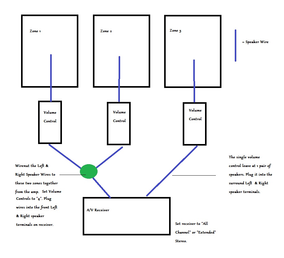

We do this all the time in commercial spaces or homes where they are on a really tight budget.
But, to make sure I understand you correctly...
- 3 different zones playing the same source with the capability of adding a 4th.
- 3 pair of 8ohm speakers (1 pair for each zone).
- 1 source shared and playing at the same time between these three zones.
If the above basically describes the system you are trying to create here is the equipment to use:
-Speakers: Whichever you would like. 8ohm is fine. 70 volt will work as well if you want to do a system like that but with so few speakers I don't understand why you would bother, but that's just me. What I am going to tell you to do is going to give you more features, be simple to install, and still come in under your budget. We just did this at a golf course. I will post pics tomorrow evening/afternoon. It works great!
- A/V Receiver: Pioneer VSX-523-K 5.1 Home Theater Receiver | 250-635
- Impedance Matching Volume Controlls: (You will need 3 - one for each zone) Wired Home VRS100 Impedance Matching Rotary Volume Control | 300-552
Total investment NOT including speakers, wiring, or shipping: Roughly $370 but you can probably find that receiver for less online pretty easily.
That's it! How do you install it? I will draw and scan a diagram and load it up tomorrow morning for you. It's very easy. Sound quality will be perfectly fine and the receiver will be in great shape.
Edit: I just drew something up in paint real quick. it's this easy to install.

Thank you, for drawing and giving a very clear explanation!
Just a few follow up questions if I can choose this option:
- so basically the impedance matching volume control takes care of the.. impedance? so that i can add multiple 8-ohm speakers but still use an 8-ohm amplifier?
- For the amplifier then basically any wattage that is higher than the total speaker wattage?
- can I use this then .. since its slightly cheaper and has similar specs: Amazon.com: Yamaha RX-V375 5.1 Channel 3D A/V Home Theater Receiver (Black): Electronics
- just for my own understanding, i don't really need a 5.1 or 5 channel system though, right? since my speakers are actually full range, and i'm not splitting the frequencies. is that correct?

Plexmulti9
does that make any difference in the diagram?
- and if this works, I can use the same speakers i already got..
thanks again.. we are opening in exactly a week, so i'm in panic mode...
That receiver should be fine. You will use the "Music" button on the remote to put it into 5 channel stereo. I will explain more about it later, but you basically have the concept down with my drawing. Get the receiver you found and the volume controls I linked and whatever speakers (yes, your 8ohm ones are fine) you need.
