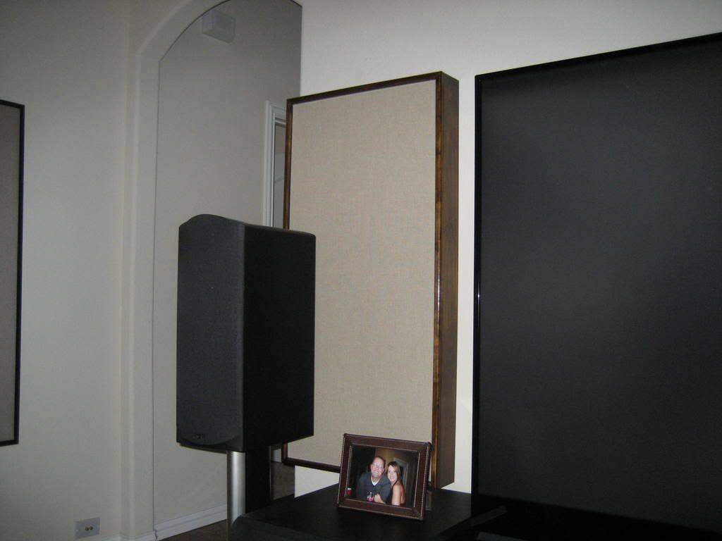

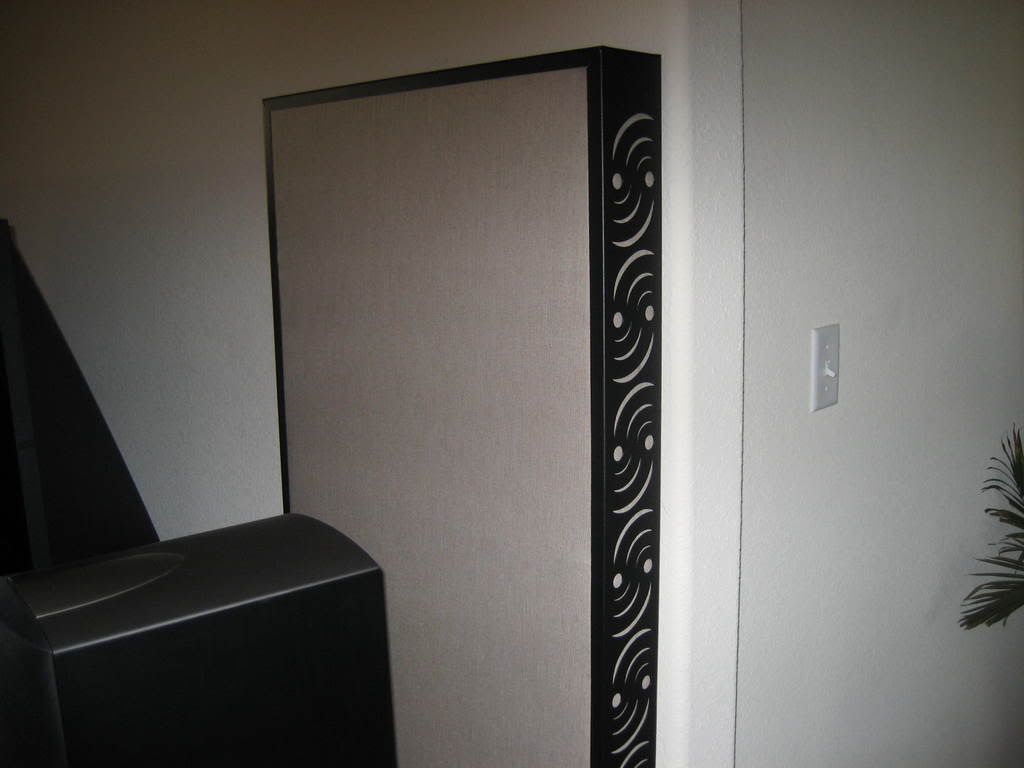

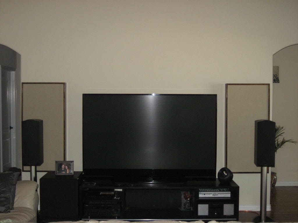

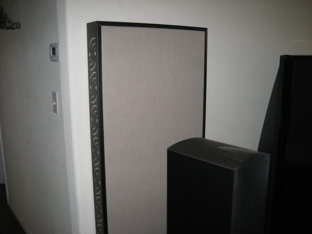

Would you mind posting/sending some picture of the GIK panels? Their website has some shots, but, they are either too small, or not in a home application.

I will in the near future send you pics of some treatments, front and back. Not sure when, but soon.
