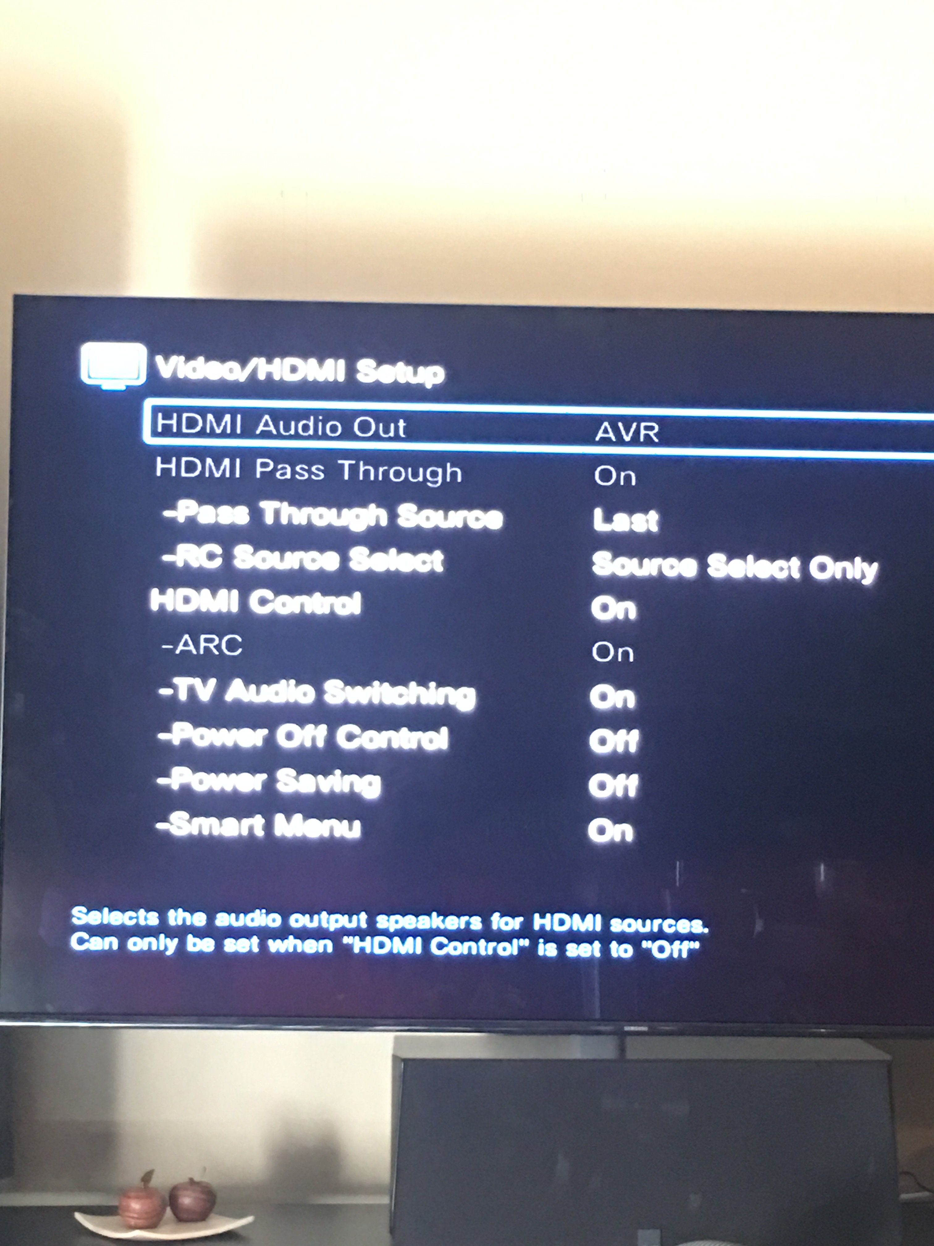

Sounds like the bullying is HDMI-CEC related. Do you have HDMI control enabled in the avr (in the setup menu - video - hdmi setup)?

Whenever I have gone to Denon CI training, they tell us to turn CEC off and have done this since CEC showed up. It causes nothing but trouble in a system that isn't limited to a few sources and a TV. Go into the AVR's menu and turn off HDMI control, too.
You need to turn if off wherever the setting lies, which is the TV, Roku & AVR.
I know, but your previous response made it seem that there were two settings, one for HDMI CEC and one for HDMI control. If you just change it in the Denon it should prevent the Roku from changing input I would think.....
Yeah, someone would think that, but it's best to turn it off wherever it's hiding.

Actually the HDMI control messed with the surround but found that by turning the RC source select to "source select only" made the roku to behave. Now I have to use all remotes but that is not a big deal! I am getting a harmony anyway...
