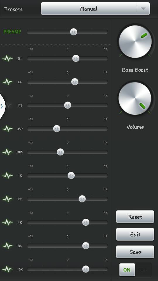

Here is a screen shot of my eq for my music player. Maybe that will help with choosing a speaker.

I like listening to rock and like the crunchy sound. I also like dynamic treble response to glass shattering that makes you jump.

markw
I'll say this much about equalizers and leave it at that: If you start boosting frequencies, you're gonna run out of power reeeeeeeeeeeal fast, and probably overdrive your speakers. You're best off using them in a subtractive mode.

The bass boost was for the headphones only.
