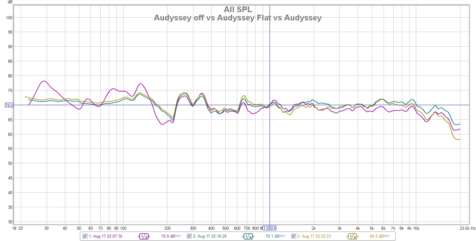

Re-Ran my Audyssey Set Up on Denon 4311 ... look at this crazy Chart.

They said roll off but did not specify how much. I plotted Audyssey off vs Audyssey flat vs Audyssey for my main speakers, following are the ones for the left channel measured from listening position. It did level the highs somewhat in both cases but still maintain a roll off.
I used to have a graph of the Philarmonic 3's with Audyssey vs Audyssey flat and the roll off was much more pronounced than on your graph. Curious how close those two look.

You have the AV8801 as well so your Audyssey should really work the same way as mine. It does depend on how you position and support the mike. I tried many times and the graph I posted were the best I could achieve in my room. I took some measurements at 1 meter from speakers with no Audyssey and they didn't look better. Oh, don't forget I have the graphs at 1/6 smoothed, if I used 1/12 or 1/24 they would look more pronounced too. My speaker are also different, they are Energy V2.3i (the second gen Veritas before bought out by Klipsch) that are probably softer on the highs than the Phil 3s but I really am not sure.
Actually when I ran the test I believe it was with XT32 on the Onkyo I had at the time. I haven't run that same test with the 8801, however it had nothing to do with the smoothing. IIRC the roll off started earlier and was much different by the time both graphs hit 20kHz. With the flat engaged, it was nearly flat until 18kHz before it started to roll off. However, by that point it could have been the mic, soundcard, or both.
I'll have to try it again and see if I can replicate the results with either the 7008 or the 8801.
