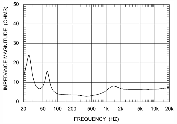

Will my Marantz SR5005 receiver pair well with the PSB Image series speakers? At present I'm having Aviano 2&5. I am thinking of T6s or B6s for the fronts but not sure whether Marantz 5005 100W will able to drive them if not whether adding power Amp will help.

Based on the impedance graph, this speaker is mostly a 4 ohm speaker. Although it's senstivity is moderately high, your receiver may run into difficulty pushing the T6 into loud volumes full range in a moderate to large room. You could get use the Marantz if the T6 is only pair speakers you are connecting to this receiver; ie, stereo only.
