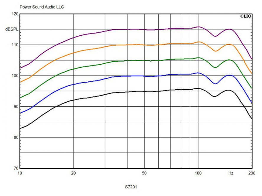

Chart only goes down to 10Hz, but unless PSA is utilizing a high pass filter (not likely), in room extension into the single digits with a useful amount of output should be achievable. Not sure why this would be a big question mark given quad 18" drivers and a high quality SpeakerPower amp in a massive sealed box.

Most microphones can not reliably measure down to 7 Hz. I have a pretty good Earthworks mic and it is only good down to 9 Hz. Most of these USB calibration mics like the Umik, Behringer, and omnimic, can not get anywhere near that low. And then there is the question of at what point does 7 Hz become discernible? TLS Guy would say it is not audible at all. According to the research that says it is, you need almost 110 dB just to be begin to sense it in a controlled laboratory environment:
So the question is, how do you know what you are hearing is 7 Hz? Even most bass enthusiasts have no way to tell. How do you know you are not hearing harmonics, whether it be from the subwoofer itself or stuff around the house that sympathetically resonates at some harmonic?
Anytime anyone talks about 7 Hz or any frequencies that low, nothing should be taken seriously unless the measurement techniques and an understanding of not only audiology but also acoustics can be substantiated. It is debatable whether such frequencies can be heard in the normal sense of the word. However we sense these extremely low frequencies, the subtlety and indistinct nature of this sensation will naturally lend itself to conjecture and mysticism that already plague so much home audio.

Valid points. I know that my pitch discrimination goes out the window at low frequencies (and I have a better than normal ear for pitch in conventional frequencies). I don't pretend to know 7Hz by ear at all! I can say some interesting physical sensations are experienced with subsonic content.
Nonetheless, among those who are inclined to measure this low largely using umik, it does give a measurement which should have some merit as a relative measure (despite not being proven as an absolute measurement).
For example, previous measurements (before miniDSP) showed roll off at around 23Hz because Audyssey was cutting his subs so much to deal with a room mode. As he tuned it and used mini-DSP to kill the room mode, the response below 20Hz and into single digits definitely increased, so the mic is reacting to something.
However, your point is well taken that the accuracy is no longer being properly maintained.
