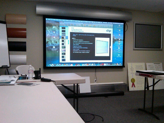

dnp Denmark. They're screens are designed for viewing in high ambiant light. Take a look at the website, www.dnp.dk the images you see on the screen are not photo shopped they are actual photos. dnp Denmark is the largest manufacturer of screens in the world with 65% of the market. Many of their screens are used in houses of worship, control centers and NBS, CBS nightly news use dnp screens.
C
Chicagorep
Here is picture of a dnp screen I took with my phone. The room was lit with 6 2x4 fluorescent fixtures
BMXTRIX
BMXTRIX
People are making jokes here... A $500 projector is typically not going to be paired with a $3,000 screen.
But, if you can talk them into buying a $3,000 screen for your $500 projector, by all means... Do so!

There's still a balance which needs to be maintained between a decent projector and a good screen. Any tab-tensioned motorized screen will run in the $2,000+ range for a quality product typically, so it really is easy to spend more than the value of a projector on a decent screen, but having a good screen doesn't fix a poor environment, nor is it necessarily a requirement as a typical boardroom situation asks for about a 10:1 contrast ratio for typical PowerPoint type presentations or basic videos which can usually be achieved by putting about 50 real lumens per square foot of screen space on a standard white screen.
The retro-reflective nature of certain screens, including the DNP can narrow the viewing angle and require a projector to be more intrusive into an envrionment where it is not necessary and where greater viewing range may be required.
In all fairness, I've seen the DNP in person and it truly is amazing and if someone has less than ideal conditions, then dropping the cash for this isn't bad IF they have the budget.
But really, my price was low by a ways. This is more like a $7,000+ screen.
For $7,000 you buy TWO XGA projectors for $1,000 so you have a backup, you buy 2 or 3 spare lamps, and you get a tab-tensioned in-ceiling motorized screen and you really are good to go for years and years to come. The DNP doesn't fix projector failures or replacement lamps, but it does make an image look good when it is projected.
