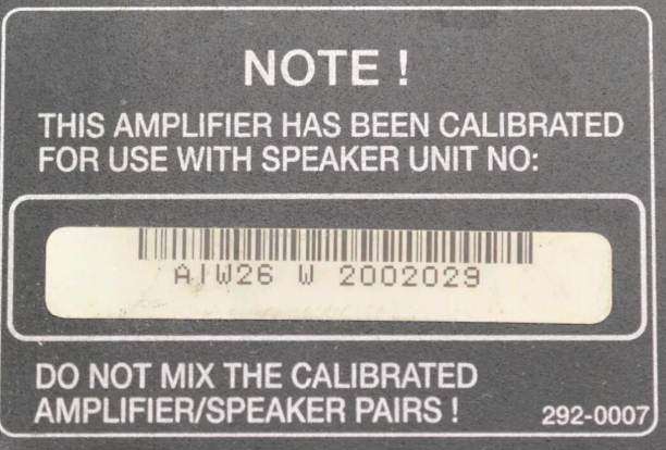

Thanks for the thoughts. I figured the speakers are pretty useless without the amps they came with. And even if I got some RAM1 amps somehow, I wonder if I'd have to send the speaker and amp in to Genelec to be re-calibrated before use, considering the warning on the RAM1 amps!
L
lwestfall
I luckily found a couple RAM1 amps on eBay which drive some of the used orphan AIW26s I got. (Still looking for more RAM1s.) Sounds great. Jim at Genelec in Boston says these should still give a pretty flat response +/- 3db but if I want the RAM1s recalibrated to the speakers I can send them to him and he can do it in his anechoic chamber for $50.
