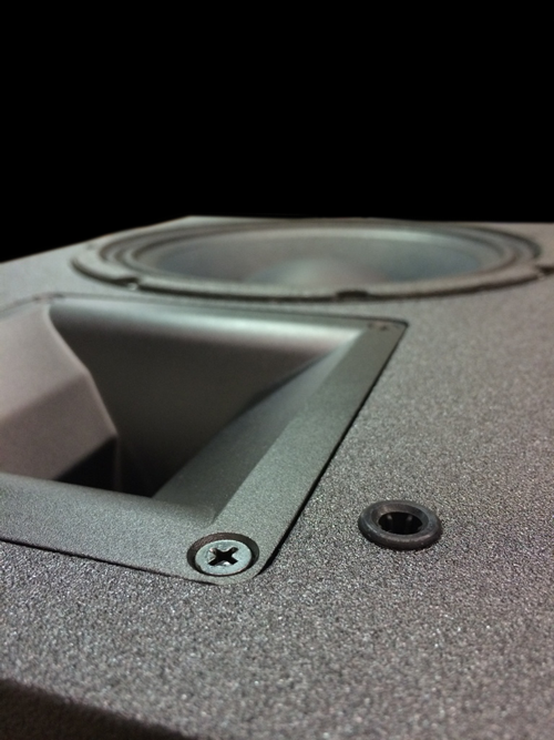

The finish on each product is quite different too. I'll include a couple close up shots of our Satin Black.
