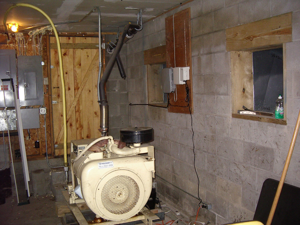

Mario Bustamante
I don't think the generator is too small. The boat is wired in 2 separate electrical systems. The port side is powered by a 32KW Kohler generator and the starboard side is powered by a 24 KW Kohler unit. The two halves of the boat are independent but can be unified by "closing the bars" so the whole boat can be run with a single generator. We can run the entire boat with the small generator in most conditions but when we are at anchor and use the zero speed stabilizers we use the large one. There are a lot of things we normally do not run (washer, drier, water maker, oven etc.) that if we ever wanted to use simultaneously would require that we open the bars and run both generators.
BTW, I believe the boat is wired with a neutral wire. The electrician will be here later this week and I will verify. I read your new post and it's very interesting. I will have more followup later. I can see your answers will be very helpful to others with marine problems.

Thank you for the follow up. Either of those two generators will be powerful enough to run the double conversion UPS without upsetting the boat's electrical supply from the diodes and thyristors in the UPS.
I'm interested in the two generators able to being linked. My question is how are the generators phase matched as they are linked? You must have generators in the same phase exactly before linking them and you need to keep them there. If the generators are not connected at perfect phase, then it causes severe mayhem in the electrical supply. At the power plants they watch the wave form on a scope of the power station and the generator to come on line. They use a dual channel scope and adjust the speed of the generator to come on line to make it perfectly phase matched. Then they bring the generator online. Once the generator is on line it will stay in phase linked to the other generators as if any generator starts to get out of line it is kept in place by the back EMF. I suspect these days there is a computer system to get the phase right at link. May be your boat has an automated way of doing this. That is another thing you need to look into, as if this is not correct then you have another problem to attend to. Incidentally the pahse has to be perfect for every generator on the grid. That is why you can rely on the clock on your oven etc, to keep perfect time.
Now one last thing. The double conversion UPS needs to have its input match the boat's electrical system. The output of the UPS needs to match the units it is supplying. All units connected to the UPS must be in identical conformity.
