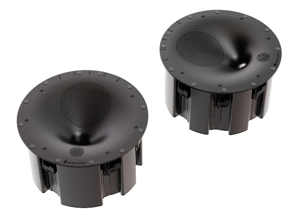

Does Perlisten have the cure for the common in-ceiling speaker?
Perlisten has launched its first in-ceiling speakers. The new S3ic ($3,495 each) is the flagship offering. Both the S3ic and the R3ic ($2,195 each) are three-way designs, and both are THX Certified Dominus Surround, Ultra LCR. The two-way R2ic ($1,295 each) is THX Certified Ultra Surround. The speakers use a new Directivity Pattern Control (DPC) waveguide to deliver staggeringly good frequency response across a wide listening area.
With the introduction of our new in-ceiling products, this truly makes us a ‘complete partner’ to the custom integration channel. Our offering is nearly as complete as possible and again we are taking the lead presenting something extraordinary with our new flagship in-ceiling model S3ic. It marks the first time a manufacturer is able to achieve THX Certified Dominus in an in-ceiling model, especially one designed for the largest private theaters of up to 6,500 cubic feet (184 cubic meters).
— Dan Roemer, Chief Executive Officer, Perlisten Audio
One thing I often hear repeated about in-ceiling speakers is that they’re a sonic compromise compared to on-ceiling speakers. After all, big cinemas have speakers mounted to the ceiling — not installed inside the ceiling. And most recording/mixing studios use active monitors for all channels, so if you look up, you’ll see box speakers with built-in amplification mounted to the ceiling for the height channels. In-ceiling speakers certainly offer an aesthetic advantage over on-ceiling speakers, but what are the advantages and disadvantages when it comes to sound?
According to Erik Wiederholtz, Chief Technical Officer, Perlisten Audio , in-ceiling speakers actually offer significant sonic advantages over on-ceilings. “Having a flat surface, i.e. an in-ceiling, is ideally the best acoustic situation you can ever have,” he explained. When the speakers are truly flush with the ceiling, “there’s no diffraction; there’s no reflections back off the wall/ceiling.” On-ceiling speakers can’t avoid reflections off the ceiling. “Once (sounds) are reflected, they’re out of phase with the direct wave coming out of the speaker,” he said. With in-ceiling speakers, “you solve all those problems,” he said. “An on-wall (or on-ceiling) will always have that problem… there’s always going to be some comb-filtering effects. That's the biggest problem you're actually solving with an in-ceiling speaker.
Read: Perlisten’s Game-Changing, THX Dominus In-Ceiling Speakers

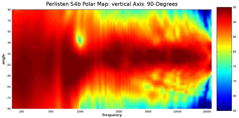

What you say Gene holds true for just about all drivers. However, it does not apply to drivers built using the math and patents of Ted Jordan. He was a brilliant mathematician.
The reason drivers beam at higher frequencies is because it gets to a point where pistonic motion is suddenly lost. Then cone motions become chaotic, and there is usually a peak and always beaming. The stiffer you make the cone, the higher the break up point, but the more violent it is, and the higher the magnitude of the break up modes.
So Ted, pondered this originally while chief of engineering at Goodmans.
Ted's solution was to make a light cone of spun aluminum, that had controlled and mathematically predicted break up that was highly controlled. So the whole cone moves at lower frequencies, but the radiating area decreases in a controlled and predictable manner as the frequency increases. This holds up perfectly until about 9 KHz. However there are still no catastrophic break up modes, and performance is respectable beyond 15KHz. The other design detail is that the surround had to be wide and very "lossy" so that there were no edge back reflections, to cause peaks and cancellations in the response.
Getting the manufacture of these light , and they are feather light, spun cones produced with consistency was a major challenge almost seventy years ago.
The result was the Jordan Watts module. His wife, who had been an engineer at Goodmans divorced him, and got the rights to his patents in the divorce settlement. She produced drivers using these patents, under the Bandor label. Ted also was in many ways difficult to deal with from a personal standpoint. After Goodman's was sold he was sacked and, so Ted formed Jordan Watts, with the Goodman's accountant, Leslie Watts. Fortunately development was well along, but that was the point where my father and I became involved. We had no financial involvement, it was R & D mainly to make the darn drivers actually work!
Anyhow, I have confirmed many times that these cones do behave exactly as Ted claims they do, and his theories predicted. So those points are the basis of Ted's patents.
Of course with all radical adventures, and this was and is radical, there are downsides. The cone behaviour required only holds up with a diaphragm diameter no greater than four inches. Since the cone is so light and thin, it is easily "oil canned" by overdriving in the lower frequencies. The compliance is high and so bass performance is much better than you might expect. The other problem in the early days, was finding adhesives that would keep the aluminum cones attached to the voice coil. I spent untold hours on adhesive research and had increasing success with the development of better adhesives.
Lastly I have confirmed many times that Ted's math and theories holds up to measurements. So speakers with this spun aluminum tractrix cones with highly controlled break up do NOT behave as other drivers do, and have very wide dispersion.

I've tried just about every full range driver, and your remarks are certainly true, with the possible exception of the Jordan full ranger, which I think was the best of the lot (it's been a very long time). However, the Jordan cone would amass dents and creases if you breathed too hard in the next room. I'm a little confused as to which version of this driver is currently available--TLS Guy seems to be saying that problem has been largely remedied.
Anyhow, my remarks only went to power handling, not radiation patterns. I'm sure Perlisten has done their homework in that regard.
