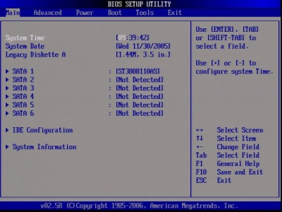

Lastly, in BIOS, make sure it has your hard drive name like so:
Where ST3888110AS is WDxxxxxxxx.
