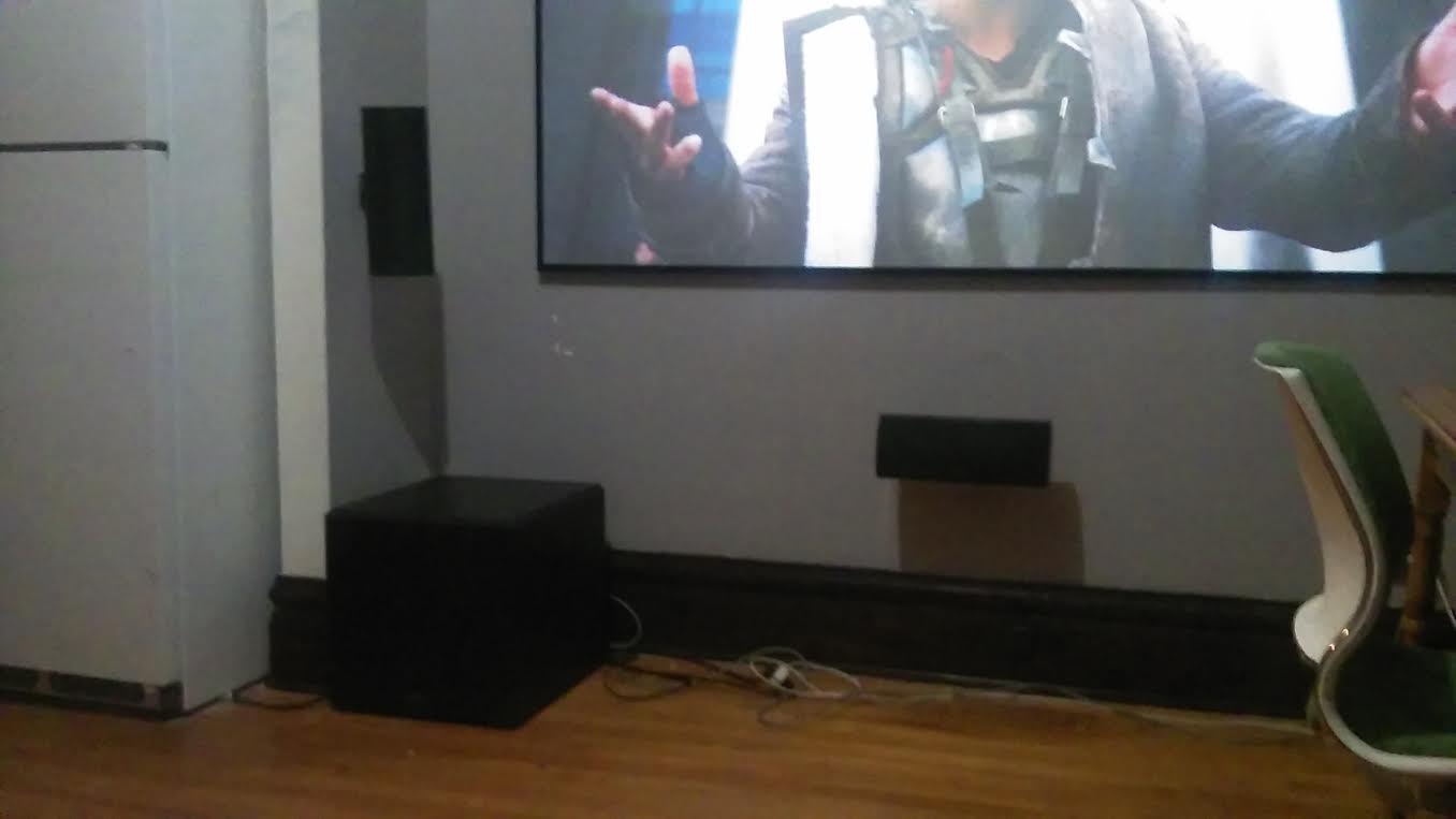

OMG... this is where I snugged it and it sounds INSANELY better. I used excess latex foam from a mattress I'm building to fill two ports. Wow what a difference repositioning and port work did to the setup. The bass is way tight, not muddy at all, and fills the space much more evenly. I can safely set the sub crossover way up to 150 (where it needs to be based on the limited rage of the other speakers) and the stuff from 100 to 150 isn't muddy.
I have to redo some other calibrations, but this made a HUGE difference.
Thanks a ton!

Note: the very low frequencies rumble so hard now. Like, shakes the floor. I feel sorry for my neighbors.

Guardians of the Galaxy? Great demo material!
Enjoy!
Yeah, mine is unplugged right now because of that very reason. I'm using a Paradigm PDR-10 in its place until I can figure something out with my arrangement. With the way my room is now arranged the PS-1000 is an all or nothing beast (it's like they accidentally made something far beyond what they expected). It only really works well in one spot and it works a little too well there. :D
