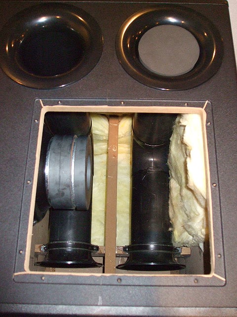

A note about the part of the review where Ricci states,
...slight amount of peaking at the port tuning. This indicates that the subwoofer could use either a little less enclosure volume for this tuning which would lower the efficiency at port tuning flattening out the peak. This would in turn require longer ports to achieve the same tuning range, or that the driver attributes could be tweaked a little to compensate.
I think it's worth noting how the VTF3 mk3 and LFM-1 EX, often said to be almost identical subwoofers, differ in this respect. The VTF3 has much more port volume; its ports not only have a larger diameter but also bend around in the cabinet for a much longer run. This can be seen in Audioholic's review of the VTF3, from where these pics come from:
To Josh Ricci: do you think these larger ports address that peaking at port tuning?
I don't know how Outlaw and Hsu exactly collaborated in designing the LFM subs, but I have to wonder how and why these changes from the VTF subs came about, since they are so similar in many other respects. Did Outlaw want them for aesthetic reasons? Did Hsu want them just for the sake of maintaining some uniqueness and not having a complete clone on the market? I know the answer to those questions are probably only known to Hsu and Outlaw, I am just speculating.
Another question I have is how would mic tests would have differed with the LFM-1 sub in its normal orientation on its feet? I understand that won't have much difference in room, I am just curious how that would have affected ground plane measurements.
Oh yeah, another question for Ricci: a criticism that has been sometimes levied against the Outlaw subs is that there is not enough clearance from the ground for the driver and ports. Do you think this affects their performance in any notable way or is a legitimate point at all? Also, great review, thanks, and I'm looking forward to more like this!
I don't know.
The issue with the peak at tuning is not caused by the port size. As you maintain the same port tuning and increase the overall enclosure volume the efficiency at port tuning is increased. You could eliminate the small peak by reducing enclosure volume and thus low end efficiency slightly. Or they could tweak the driver itself and how it behaves with that volume and tuning. Or they could simply use the rumble filter or even a tiny bit of EQ to get rid of it. It is possible that it is even caused by the microphone placement relative to the ports and driver. Closer placement to the ports will accentuate their output more. In the grand scheme of things it isn't a major issue. Room acoustics will completely swamp this at the listening position in most cases.
The LFM-1 EX could use a bit more port area as it will overload the 3" ports used especially if one is blocked. Dual 4" ports would offer higher output before vent compression and noise sets in. However they also take up more enclosure volume and need to be longer to maintain the same tuning. This also drops the port resonance lower in frequency as well. Tradeoffs.
