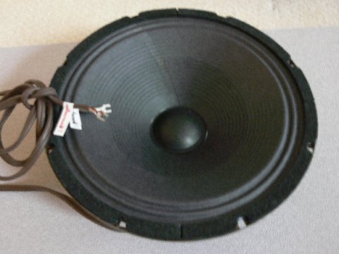

Pyrrho,
Thanks for he pointer to use MillerSound.
Bill and his team did a great job and created a custom near full-range ~8ohm speaker to complete the project in the original basket preserving the look this period piece.
