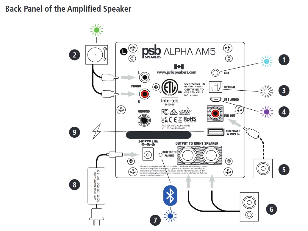

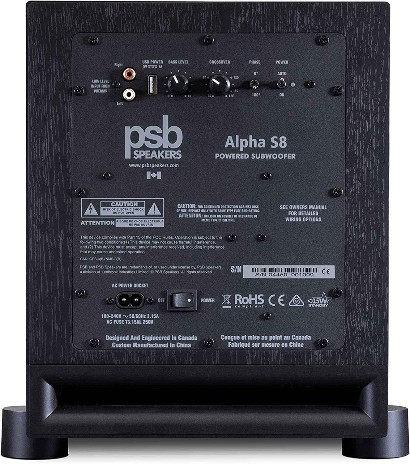

So in anticipation of going to the shop tomorrow I've been studying the two manuals.
The powered speakers has these connections on the back. The key is that it has one Sub-Out. None of the documentation mention LFE on the powered speakers.
Powered Speaker back

Below is the back of the powered subwoofer. It has low level RCA left and right inputs. Neither is labeled LFE but it has LFE controls. Do I need a single mono RCA cable to split to two mono RCA for Left and right or can I simply run a single RCA from Sub-Out on the speaker to one or the other (left or Right) on the subwoofer?
It's maddening when stuff has pathetic documentation but it's become the norm.
You can just use a single cable.
Yes, you can use just a single cable....on an RSL sub, the left input is used when using a single cable input....not sure is PSB is doing the same.
