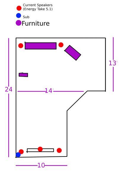

About a month ago i ordered a full 5.0 set of SVS speakers with floorstanders...
Its now time to order a sub. My budget is $700 +/- the kicker is my room is a little on the large side.
Jack @SVS recommend the PC12-NSD, personally i LOVE the form factor of the 14" cube of the SB12-NSD, but Jack felt the small sealed sub wouldnt have enough umph in my large room.

My handy calculator comes up with 2300cuft - that's not a huge space. It's a nice size living room but not big enough to be a problem space. On the other hand if it's open to anything else (hall ways etc.) then you have to count that space as well. Get a hold of Elemental Designs and Hsu Research and get suggestions from them as well but I don't see a big problem with 2300cuft. Also keep in mind that a subwoofer can make a fine end table.

My handy calculator comes up with 2300cuft - that's not a huge space. ...... I don't see a big problem with 2300cuft.
So how would a smaller foot print sub like the SVS SB12, NHT B-12D, you know... hight WAF subs... perform in my room?
I have no hands on with those subs but I use a Hsu ULS-15 in my 3000cuft bedroom and it sounds great - but it's a bigger, more powerful, more expensive sealed sub. G-EV hit the nail on the head with the difference in sound between sealed and vented. Sealed are tighter and wonderful for music but the smaller ones can struggle with 20hz movie explosions. That's where vented subs excel.
