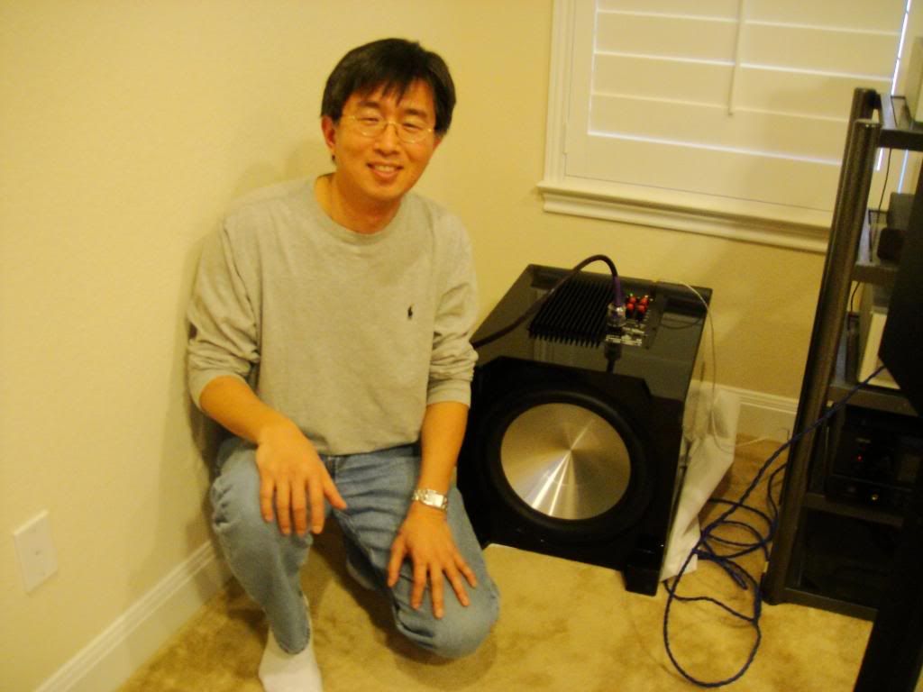

Here's a pic for you too Ty!
Brian Ding, Rythmik Audio owner, designer and builder with a Rythmik D15SE (c2010)

Too funny GIEGAR! :D
