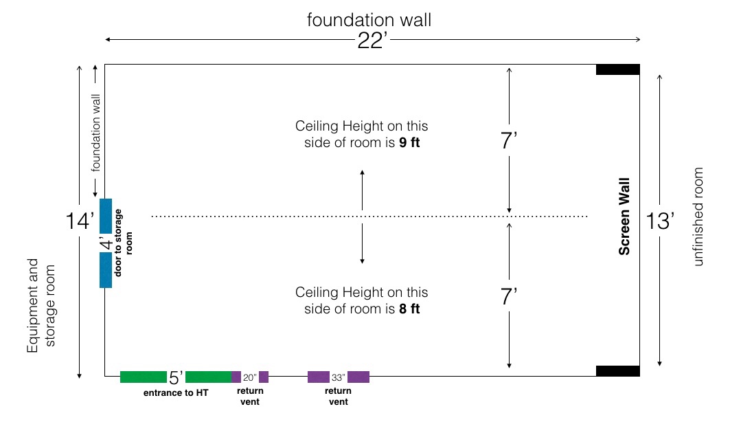

Hi all
I am in the process of finishing a room in my unfinished basement as a dedicated home theater room. I've been reading up on this forum and learned quite a bit since this is my first time attempting a home theater build. The more I read, the more confused I got with making my gear selection. So, I decided to join the forum and ask the experts for advice.

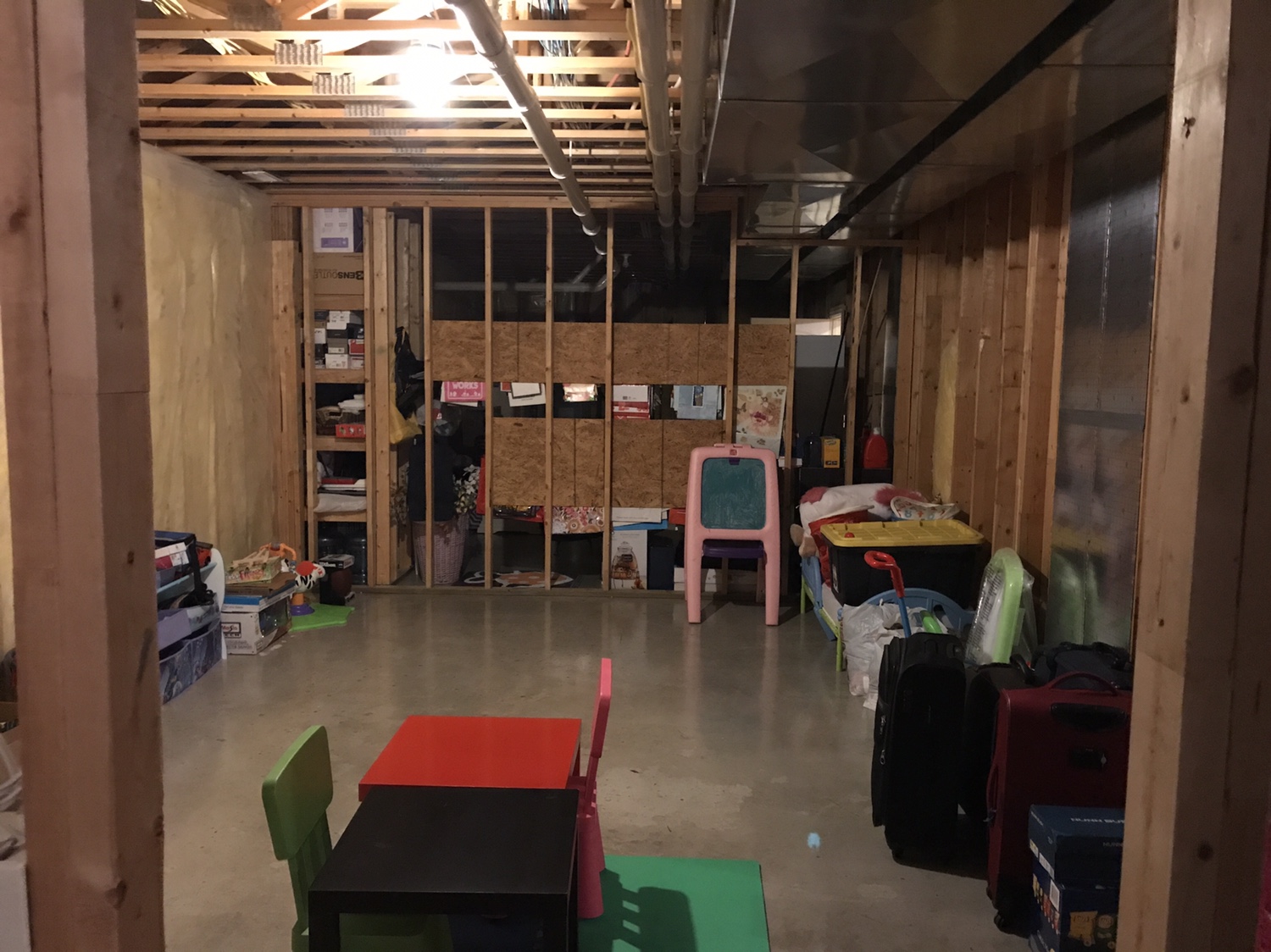

I've tried to capture the room dimensions in the attached picture. I don't have any gear at all. I would like to keep my budget up to $5K.
Could you please advice options for the following:
Receiver
Speakers for Atmos 5.2.4 setup
- prefer to have in wall speakers for surround
- prefer to have in ceiling speakers for height

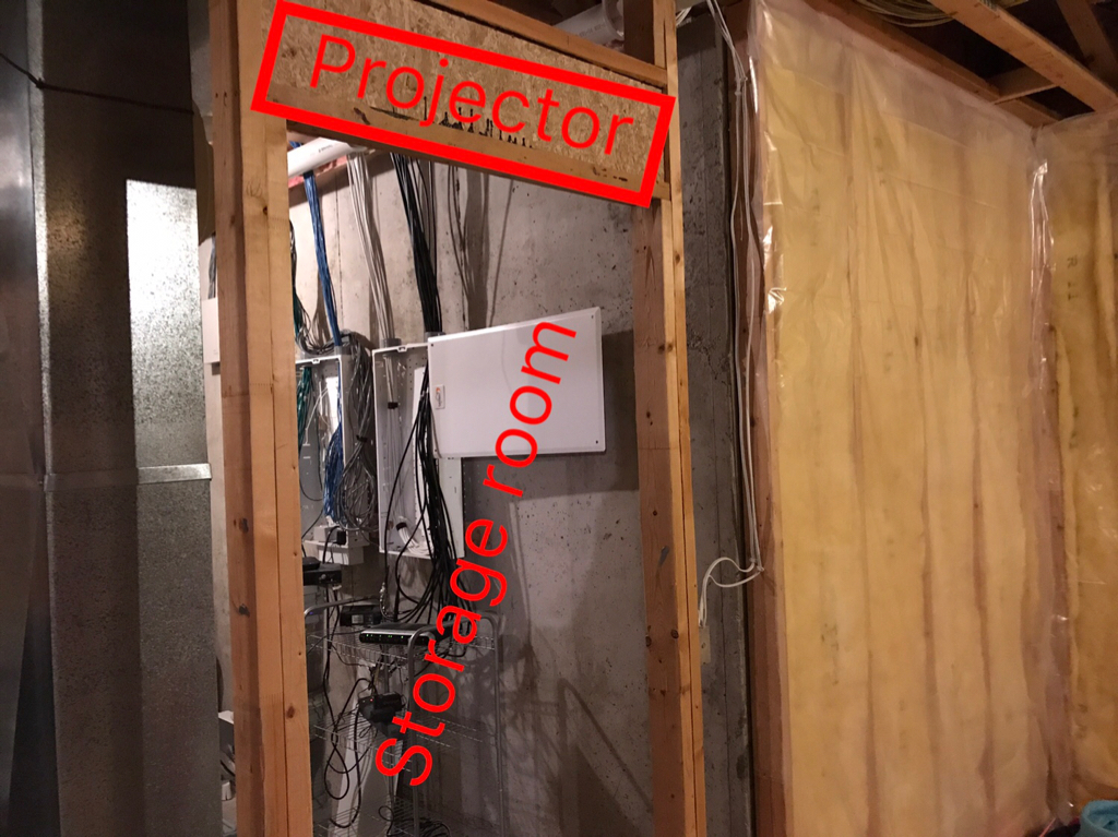

Projector (plan to place this on top of the door to the storage room - shown in the second picture)
Screen
I don't plan to have formal home theater style seating in the room.
This may be off topic but should I go for 8ft uniform ceiling height across the whole room or is there an advantage to have 9ft ceiling height for half of the room?
If I'm off track with what anything I stated, please correct me as I'm new to all this.

For the projector, the Panasonic PT-AE8000U would be a good choice. At 22 feet, it'll project on any size screen from 112" diagonal (98" wide) to the limit of horizontal width of your screen wall. Play with this projection calculator. We'll estimate $400 for a DIY screen (material from Carl's Place + wood frame + L brackets and screws from Lowe's + black velvet tape border + a string of $20 LED lights to line the back edge if you feel like it). *shrug* That'll leave you around $2800 for speakers and AVR.
I recommend jumping on three of these JBL Studio 580 for your front LCR as soon as you can. No telling how long they'll be that cheap ($389 each as of this post). They're usually twice that much or more, and the JBL store has already reverted their price back to full retail. If you can score them, that leaves around $1400, but you'll have to source some acoustically transparent screen material from somewhere other than Carl's Place. I don't see any on their website at the moment. One of the other veterans can probably recommend somewhere.
Subwoofer: Hsu VTF-2 MK5. That'll leave about $800.
AVR: something cheap. Yamaha 5810 refurb, leaving ~$500.
Side in-wall surrounds: Monoprice w/ AMT tweets, leaving ~$400.
Pair of in-ceiling speakers: Monoprice w/ angled drivers, leaving ~$320.
My poor math: probably $320, leaving you with your entire budget spent. Enjoy! Spend the rest on Monoprice CL2 speaker wire, a Monoprice subwoofer patch cable, maybe consider upgrading the sub to a Hsu VTF-3 MK5 or adding acoustic panels, or budget for a Harmony remote. Or the acoustically transparent screen might eat up the remainder of your budget. Don't know.
But if you want more speakers, you'll have to increase your budget or go with a lesser quality front stage. 9.x channel Atmos-capable AVRs jump up an additional $400 on Accessories4Less I believe, then the speakers themselves will add another $80+.
Difficult to say. My guess is your bass response will probably be a bit more uneven with the dual-height configuration. It would've been uneven with a uniform height anyway, so it's probably not worth making an effort to avoid. The best way to combat that would be with dual subwoofers, for which your budget does not allow As a benefit, the staggered ceiling might trap and tame some other reflections and make your room a bit less echo-ey -- but probably not by that much. Ultimately, I'd just let aesthetics dictate your decision.

Before you think gear, think about how to construct/finish the room. More than any piece of gear, your room will have the greatest impact on the sound. Many years ago I started with concrete walls and ceiling joists as I built out my basement theater in my old house. Comb through my old posts as I asked a ton of questions. For example...given you have open walls, run either conduit or all the wire you could possibly need now and in the future (I ran conduit and it saved me several times). Think about how to isolate sound from the rest of the house, particularly the upstairs through the ceiling. Think about where you are going to place a subwoofer now...multiple subwoofers in the future (i.e. run the wire now). Make sure you have enough power to the and Ethernet to the component closet.
Granted I went a little overboard, but I spent about 9 months researching/designing the room and then 6 months (nights and weekends) actually building it.

How much space is required below the screen for the center channel speaker? Would 28 inches be too constrained even if I have it positioned at an angle towards the ears?
