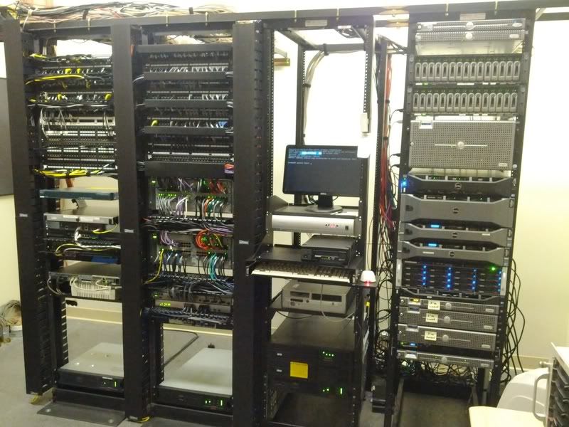

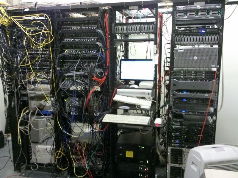

Started a new job about 6 months ago and have been really busy which is good!
I'm the only IT guy for about 75 employees, 100 servers (15 physical), and a network that was in complete disarray.
Went from this when I got here...
To this as of last week!
BMXTRIX
BMXTRIX
Good work on the cleanup of that f'n disaster area!
