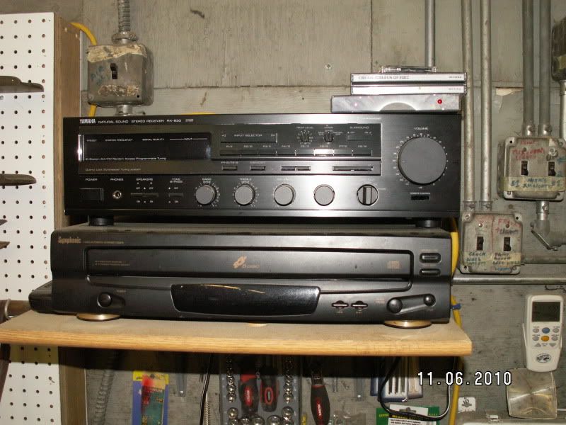

I recently got a couple of rec'rs off eBay for Eddie's shop. Both of them together cost $38. :eek: I think they were 70 watt and 85 watt Yamahas. Testing them with 6 Ohm Aiwa (screw those jerks for having a name that is unpronounceable and spelled wrong even when it's spelled right) bookshelf speakers revealed that the 85 watt one got the test tune much louder with much less distortion than the 70 watt one. This was a night and day difference that went well beyond the difference of 15 watts but yes when they were played at low levels there was no preference.
The good one ... :)
To bring my point back to the topic I'll say that Walter has an amp rated at 350 watts pushing his center.
