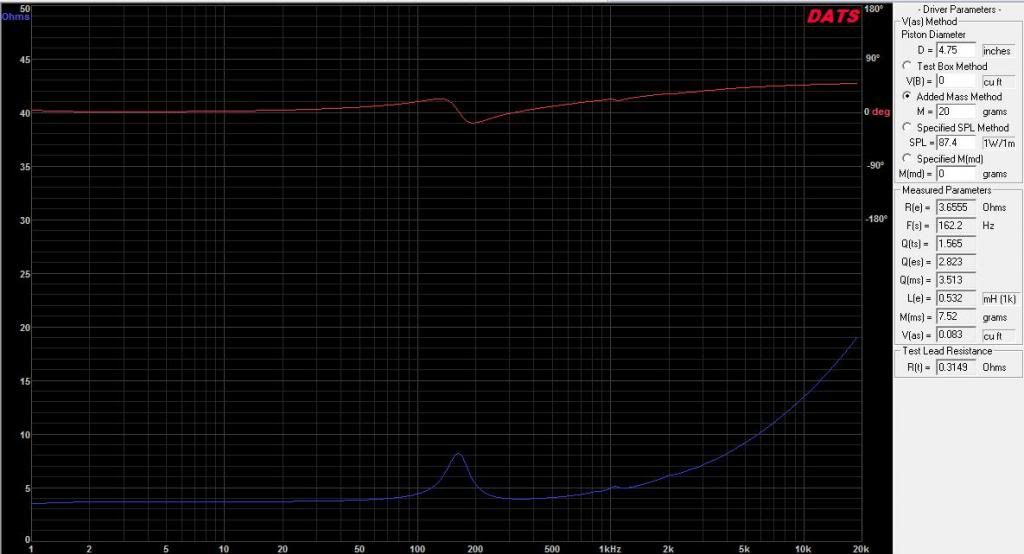

    I will try a model later, but I do need the cone area or diameter. I can tell you by dead reckoning it will need a small sealed box and F3 will be somewhere between 250 and 300 Hz. It will have no useful bass.

    From the seller and just confirmed by Eddie.
    Eddie actually has the center to center measurement at 4-5/8" and the cone itself is 4" before it attaches to the surround. I'm not sure what the depth of the cone is so even if I could remember the formula for area on a cone (which I can't) I can't provide a number for area. I haven't really searched yet. Is the diameter alone enough to work with?

    Yes, it is.
