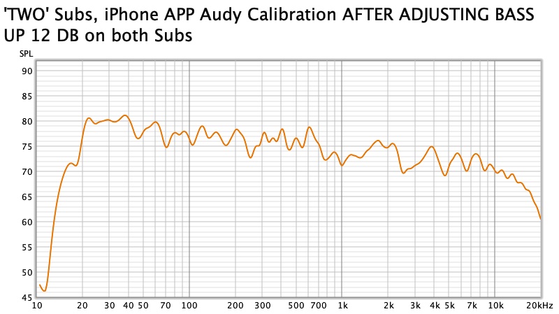

It's the phone app. I redid the calibration this morning with the phone app, Audyssey MultiEQ editor, and got with the TWO sub arrangement the same -10-12 dB deficit in the subwoofer bass output.
But after adjusting the bass output upwards 12 dB, I get this curve measured by REW. It's a start. Please feel free to comment on the curve, especially how to improve. Is there a standard for the amount of smoothing?
And many thanks for all of your comments and help with this.
Looks fine, not that it means much but I wonder why it dropped precipitously at around 22 Hz and still have no idea why you need to bump the bass level (trim level?) up by 12 dB. I could even understand 6 dB to get that tilt, but 12 dB seems more than necessary that still indicate without that there would be the unexplainable low shelf that should not be there in your large room and very capable subwoofers.
Regardless, assuming smoothing is not more than 1/12, you now have a fantastically "flat" and smooth response from 20 to 200 Hz that are not seen too often without post calibration tweaks. The fact is, that +12 dB works good for you, what causes it is only important for crazy people like me, who would not stop until I found the cause(s).
My only slight concern is that without knowing how much boost Audyssey might have done at some points within that range, the pre out (ie the subouts) may be in the clipping zone at times, as preamp voltage of a 12 dB extra gain means the voltage will quadruple. If it is at say 1 V level without the boost, with 12 dB boost it would reach 4 V. That's find, but at higher listening level when you get a 20 dB peak, you could be talking upwards of 8 or even 16 V (XLR outputs) depending on the gain of your power amps. Having said that, humans are much less sensitive to very high distortion levels in the below 200 Hz range.

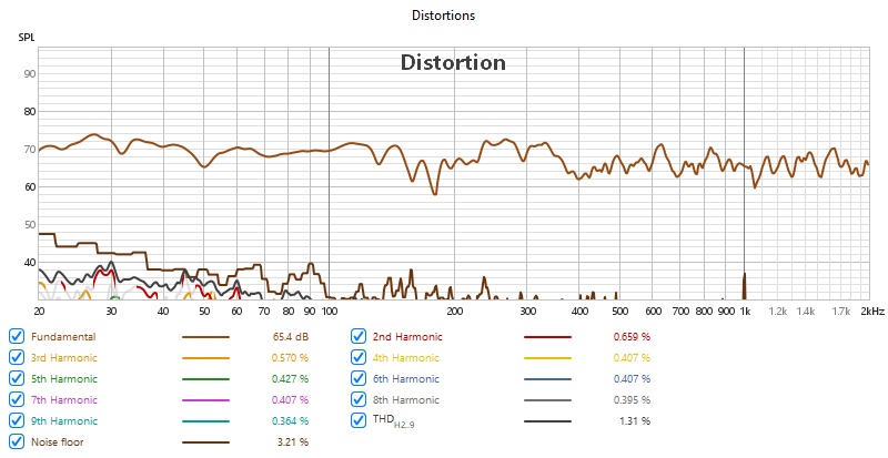

What's REW showing for distortions?
An random example I picked from my sweep inventory, that's a sweep at low level, I imagined it would have been worst if I had cranked the volume up.

Well that looks pretty damn good! Smoothing imo is usually set to none while doing adjustments, and whatever you feel like after that to show how pretty it is lol. I normally don’t use any. FWIW.
Yeah, looks pretty. Good. As with @PENG, I’d be concerned with distortion. +12 is a hell of a lot. So curious, where audy set it initially. In the sweep it looks like about 82db. That’s not much compared to a big 115db movie hit. Of course if you never get the MV above -20 or whatever, it wouldn’t much matter. Except that if the LFE trim value is in the + you can have distortion in the signal. That’s a whole different problem.
So A) we want to figure out why the initial setting is so low. Or B) just roll with it. lol
I’m assuming you’ve done some listening? I would expect at least some improvement over when you started this thread.

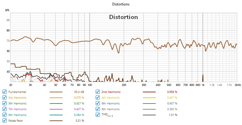

An random example I picked from my sweep inventory, that's a sweep at low level, I imagined it would have been worst if I had cranked the volume up.View attachment 66197
So I’m not sure what you mean by the 22hz drop. I can see it there clearly, but just checking for what you mean. The Klipsch subs were measured by sound and vision to have f3 of 22hz and f6 at 20. The svs are probably in the native 20hz(with bungs available to tune to 16 and 12 iirc). I suspect some anomalies here due to to that.
If it were me. I might consider lowering the tune of the SVS’s to 16(and 12 for fun) to see if that improves the sub 22hz range. They have a lot of capability and it could improve extension while possibly cleaning up that low 20’s area. I’m still working on coffee so it’s possible too, that I should not be typing yet. lol
Paul McNeil
Yes, that's the unresolved question, it's the phone app, but why is it so grossly misadjusting the bass?

Initially it was set at -9 dB by Audyssey phone app and it is now +1dB, so there should be plenty of head room from the AV10, or no? This is exactly the question I asked in the original post, how best to adjust the bass. At the AV10 level or subwoofer level. The AV10 has the SVS set to -35 dB. Well, after all they are two together (+ 6dB gain) in a corner (+ 3adB gain), and are those additive or multiplicative, in either case a huge gain factor.
