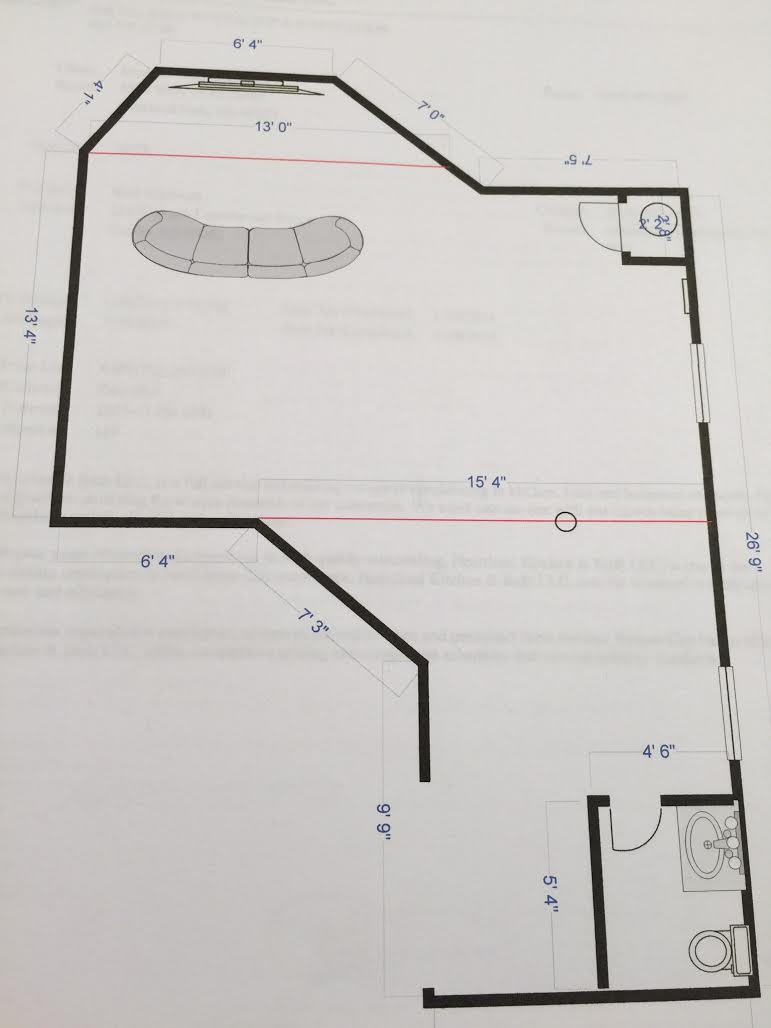

Hello.
We are refinishing our basement from scratch and look to begin framing by the end of January. So, this is yet another request for opinion and feedback as I’m just not sure of a few things as I have read many, and like most of you, many forum posts in trying to get a more learned overview of all of this.
A few questions then some answers/statements to help with the suggestions:
Any recommendations for also including a dedicated 20amp circuit for either my plasma or the power amp?
Based on the diagram, any idea on rears? On-walls? In-walls?
I have heard some Klipsch speakers and not a huge fan of the horn tweeters. Love the GET Heil/AMT/HVFR tweeter sound though.
Not opposed, in fact appreciate $$$ saved, to going the pre-owned route ala accessories4less.com, audiogon.com, and audioclassics.com
Viewing area for LP is estimated to be between 12.6” – 14.6” depending if we elect to have a small barstool/table behind the multi-piece couch for eating while viewing
The wall with a distance of 7’ 3” on the drawing will not be at an angle as we will be squaring that off for better on-wall or in-wall rear surrounds
Expecting to start off with 5.1 and eventually move to 5.2.4 setup

Room size is included in drawing with no placement restrictions or no aesthetic or size concerns

Are you planning on using the 13'4 wall for the display and sound stage or the spot the display is on?

Having heard a few different Golden Ear speakers in the past, I always thought they sound fine. If that is what you like, that is what you should go with. My advice is to just go with Golden Ear Bookshelf Aon3 speakers or the Triton 7 towers. The reason is the upper end towers will only get you more powerful bass, but if you get a good subwoofer, you will have that area covered, so it is money wasted. I would just get some bookshelf speaker fronts. I would even get a bookshelf speaker for the center speaker if you can accommodate that. I would try to avoid the conventional horizontal center speaker if you can.
That said, many of the speaker brands you mentioned should do fine. Revel, Kef, SVS, RBH, all very good brands. One thing I would try to do if I were you is get two subwoofers. This way you will get a more even bass response throughout the room, and therefore a better sound, and you will also be able to use a higher crossover point for more powerful bass than what your main speakers will be capable of. In that room I would go for ported subwoofers. If you like your bass loud, I would go for two Hsu VTF3 mk5s, but if you don't need monster bass, go for two VTF2 mk5s, or RBH Sound I-12s if you need the subs to be pretty.
For home theater, twin subwoofers are a great way to add punch and smooth out the bass response in general. Shadyj speaks the truth.
HT... I hadn't really looked at the room differently. Are you suggesting that I use that wall as the front (tv and L/C/R). The diagram is a little misleading as the plan would be to have the TV nearer to the line in the 'alcove' measured at 13' wide to accommodate the 65" Panny plasma and L/C/R and a sub or 2.
Shady, thanks for the consideration of the Aon3 which I'm seriously considering. Would the dual Hsu VTF3 mk5s compare well with the SVS PC-2000 or PB-2000 and the VTF2 mk5s to the SVS PB-1000 or the $399 per SVS SB12-NSD (sealed) wheres all the others are ported?
The VTF-3 mk5s are beasts, and will outperform the SVS 2000 subs, likewise the VTF-2 will outperform the 1000s. But then again those Hsu subs are a bit more expensive and don't come with a 5 year warranty. You can extend the Hsu warranty to 5 years for a bit more. The SVS subs are good, but I wouldn't step below the 2000 series. If you don't need major output, the Hsu subs might be overkill, but still, its better to have it and not need it than to need it and not have it.

That depends on if you are dedicating the whole room for HT with music listening as well or if you plan on having a pool table and area for more than a few friends at a time really. I like walking into a room from the rear and seeing the screen and soundstage right as I walk in. If it's in the alcove it seems that it isn't the main attraction to me because it's off to the side and doesn't have full room dedication. Mind you I have a side split home with 4 floors all at 440 square ft/floor usable living space. So I used the lowest level below grade and made my dedicated HT 20.4 ft long x 12 feet wide. The ceiling is lower at 7 feet . The room has zero natural light and can be entered from two doors at the rear left corner. You may not have that with your home layout so you do what you can. I was reading your goals and was thinking you need two systems. One dedicated for HT and you could use the alcove then pickup two moveable dividing walls kind what you would see separating large office space so you could create a division in the room when HT is the main course of the day and then use the other system for your gatherings of friends where you want to play the rock loud but aren't using a tv display. You just use the same receiver/ssp and amp and set it for zone 2 to drive you bar with loud speakers like Cerwin Vega. A lot of equipment allows for multi zones so all you need is an amp for the second zone and some badass 15 inch Cerwin Vegas to light up the party.

I'm having a member of Independence Audio Video (local KC area HiFi shop) to come by next Wednesday afternoon for a free consultation.
Interestingly, Indep AV sells B&W, Paradigm, and GoldenEar speakers with Anthem and now Marantz components.
Thank you for your recommendation.
Keep up the research and the fact checking. It would be nice to see how your project turns out. Some photos maybe? Also what you think of the sound you end up with. It's always interesting to see how reality treats expectations.
