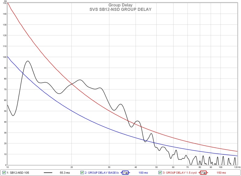

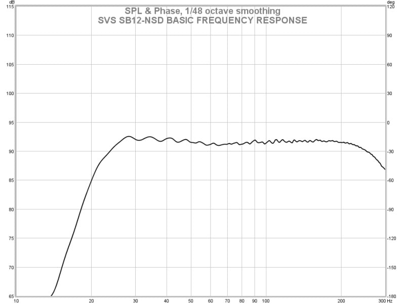

Response shape explains everything here. Look at the SB-1000 and SB-12 NSD responses:
SB-1000:
SB-12 NSD:
Notice the boosted response knee and heavy high-pass filter slope. SVS wants these subs to imitate the response of a ported sub, but they have very little excursion at the low end to carry out that response for anything more than modest output in that range. This isn't bad if you want more deep bass in a room that doesn't get much low-end gain, but it is not a good idea for integrating these subs into a room that does get substantial gain. In my opinion, these subs do not have enough displacement to make this type of response curve worthwhile. Thankfully SVS has corrected this somewhat with their SB-2000 frequency response:
With the ULS-15 mk2, you can set the response either way to suite either situation:
Its Q control can also give you some fine-tuning ability to adjust the response from there, as well. I believe the S1500 also has a selection of responses to fit levels of room gain too.
SB-1000:
SB-12 NSD:

James, how is it that two SB1000s aren't going to match anything the LS50s are going to do? I've heard the LS50s; in a 12x15 room I seriously doubt they can drive more than 95db peaks at a listening seat at 100Hz. I think they do sound better than the 5+ for music within their limits (a lot better, actually), but volume monsters they're not.
I don't think the LS50s are as limited as you think. I have heard a pair handle a large conference room pretty capably, and I don't think they lacked dynamic range in that instance.
As for being a match for the SB-1000s, I don't claim that they are or are not. I don't really know the dynamic range of either one. What I am saying is their response shape may not play well in a room with substantial gain. If room gain starts building up a lot below 40 Hz, than you are going to have an elevated response below 40 Hz with a subwoofer that has an intrinsic flat response below that point. That may add a sense of a delayed response to music with subharmonic content in that region since deep bass frequencies take so long to develop (also human perception takes longer to recognize deep bass sound than other frequencies).
Furthermore, the low excursion of these small sealed subs can easily get overtaxed by deep frequencies. Remember that it takes four times the excursion for a sealed subwoofer to play 30 Hz as loudly as a 60 Hz signal. What is the Xmax of the SB-1000? 10mm maybe? It really shouldn't be trying to play deep bass at all. It will rapidly run into heavy distortion unless it has a very strict limiter. By the way, those type of filters can add substantial group delay, to wit the GD graph of the SB-12 NSD:
All that group delay is necessarily the product of the filters used to give it its response shape. Since the worst of it is mostly under 40 Hz, it probably isn't that audible, but it just isn't needed at all, because its response shape was, in my opinion, not a great choice for its design. The SB-1000 looks to share this problem, but the SB-2000 looks like it has a better response shape for this type of design.
Even though I just went through some problems that I see with the SB-1000, I don't think it is terrible. I am sure it can be made to sound fine. I think it would not be suitable for applications with a lot of deep bass. For conventional music, it should work well, and the size and weight are real pluses.
