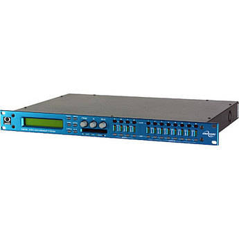

With car audio digital crossovers like the Bitone and JBL MS-8, and Pro audio ones like the DCX, it seems the hi fi market continues to get the snub in terms of these things.
While the MiniDSP, the Hypex Bi-Amp, and Mark Seaton's Catalyst are all a choice, none of them seem to have the form factor I really associate with Home Electronics (and one is a whole speaker mind you)

The leader in zero phase crossovers and and time aligned crossovers are the Australian company DESQ. They have 20 years experience in this field. I have watched their progress with interest for a long time now. They used to cost a small fortune. Their prices are now in the range where I am seriously interested in purchasing one of their units, at least for my mains.
The other proponent who has a true digital crossover in the field is Roger Quested who has a unit and a line of active monitors using digital active crossovers. His crossover is still very pricey, but versatile and professional.
You can purchase one here.
You can purchase a DESQ unit direct for $1950 USD.
I have a feeling this technology is soon going to burst out mainstream

TLS Guy - if you implemented this (DESQ unit) for your mains, how would you reconcile the difference in sound for your center? Perhaps a "defeat" switch during HT use? Also, sounds like you would need to also add a component to switch RCA to XLR and back?

I have never heard the Orions, so I can't guide you. However I hate resonant speakers, so I likely would like them, I wonder what spl they generate though, as I hate speakers weak in the wind. I favor low Qt speaker systems. I like around 0.5 which is lower than usual. But that way piano, bass strings and tymps sound right.
As far as matching is concerned, good is good. Good speakers match each other. Timber matching as I have stated many times is what I consider error matching.
When I design a speaker, no matter what drivers I pick, I do the following.
1). I'm absolutely obsessional about getting a flat mid band response.
2), Design for low Q preferably with TL if space permits.
3). Aim for as wide a horizontal dispersion as possible mirroring on axis response.
4). Optimize step loss compensation specific to the speakers position and environment.
5). Try and limit vertical dispersion.
6). Limit cabinet resonances as much as possible.
7). Do as little violence to time and phase as possible, consistent with a very smooth mid band response and keeping the drivers within their pass bands.
The end result is that what ever the drivers there is a strong similarity between all my speakers.
Now in my mains there are already two active crossovers and one active crossover on the center. I have passive crossovers to the tweeters on both mains and centers. I have had a hard time justifying another three amp channels to get ride of those passive crossovers. I build my crossovers with very high quality components and they are built to a standard only found in very expensive speakers indeed.
As you can see the center uses different drivers and in fact coaxial ones, although the lower tweeter only is used.
Centers are a problem. You want a nice coherent source for voice. You need it close to the screen. You want dispersion to just cover the listening area, so as not to excessively interact with the mains.
The only option would have been a full three way with the tweeter below the mid and two woofers either side. However for optimal speech you need a mid driver with enough bandwidth to crossover 400 Hz and 4 kHz. Only three mid ranges fit the bill. The B & W, but they won't supply them.
The Dynaudio D76. They kindly supplied two for my system downstairs.
See if I could get ATC to provide one of their units, or PMC supply me one of their ATC modified units.
So I settled for the best coaxial unit around. The downside is inter modulation distortion because the tweeter boundary moves.
In the event it has worked out well. You here no change across the front sound stage. Opera singers left, right center or anywhere between have the same vocal presence and intonation.
But I might get curious and see what zero phase time aligned digital crossovers can do for us. For a speaker system of this value the cost is now ball park.
